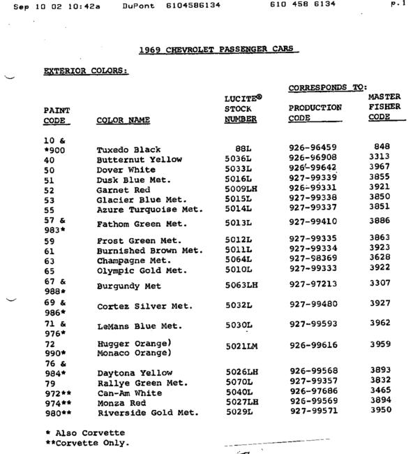

SOLID COLOR 926 - 99568 - YELLOW (all hand written)
This number (926 99568) matches the number on the trim tag (cowl tag) right
before "PNT" as well as "-" (TR 753 926-99568 - PNT). I've seen on other
cars ordered with special paint that have the "-" or "--" but never a eight
digit code before it.
Bottom line...I need to be correct in choice of paint color before I paint
this car. Having spoke to others, some have mentioned the color to be
"Daytona Yellow" or "Sunflower Yellow" (any real difference?). I've yet to
see a good representation of these colors in any paint chip book. Could the
eight digit code on the build sheet and trim tag help determine the true
paint code...?

This looks like a DuPont paint code. I would visit a paint supplier who sells Dupont Automotive paints and see if they have a listing in thier 1969 automotive paint chip books.
This dupont site can research you code for a fee http://www.dupontautomotivepaint.net/index.asp
"Ketone can now assist you with providing you with the mixing formula for DuPont automotive paints or technical advice for $5.95 per formula or per question"

Checked my Dupont book, shows 52 (912) sunflower yellow, late 70as in end of run year. Daytona yellow shows 76 (984) 69.Yes there is quite a difference in the two colors. What is the build date on the car? If its before spring of 70 probably to early for sunflower. I personally have never seen a code 52 SS 70 Chevelle. Novas, Camaros. but no Chevelles.Not saying there wasn't any, just never saw one that was original.Will be interesting to see what this shakes out to be. Ken S.

The area of the most confusion for me is exactly what the eight digit code means - Tracking number, paint code, special order number, COPO number...? The "926" at the begining would seem logical to be a paint code....yet, I haven't been able to find a color for that code. The 99568 code...no idea...9568...copo number?
