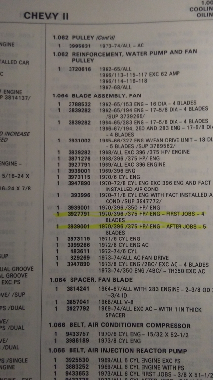

What type of fan was used on a 69 L78 Nova ?
I have seen a 4 blade non-clutch fan and a 772 7 blade clutch fan mentioned not 100% sure ?

I have seen only a 4 blade non clutch setup on early cars and then a switch to a 5 blade non clutch set up later in the year. I have never seen a 772 clutch style used on a L/78 Nova. Ask Rowdy Rat to help out too..BKH

I have a March built 69 L78 Nova...It has a five blade fan.

The 3947824 was replaced Mar of 1970. The 1970 L78 fan switched back and forth with 2 different part numbers for a 5 blade fan. Which is typical depending on the source of the part. Have you check an assembly manual for 69?
PART NO DISPOSITION Replacement DATE changed Page
3947824 USE 3976060 3-70 120

Those part#'s you are listing,are not Fan part#'s.
*3947824 is a 1969 Assembly line B/B Deepgroove Fan Pulley.Used on Special Hi-Perf solid lifter engines.
*3976060 is a 1970 Assembly line B/B Deepgroove Fan Pulley.Used on Special Hi-Perf Solid lifter engines.
The Fan is a different part # altogether.

Well, I guess it was late. I just looked up the number Martin listed "It's 3947824EV" in the prevoius note, in the parts number history DB. When I looked at the 1970 Assembly manual. I saw the two other numbers I mentioned. I should have quoted them. They are 3939001 and 3947128. If I would have looked closer I would have seen the 6060 was listed above the blade.
