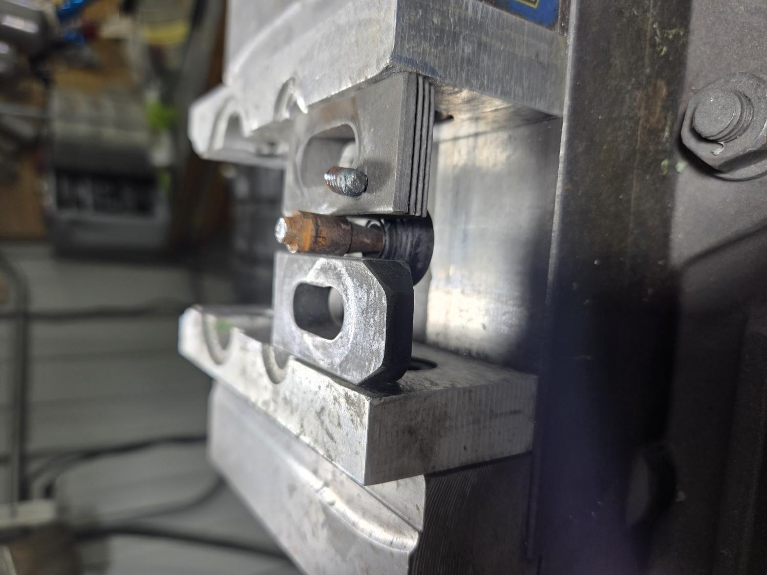

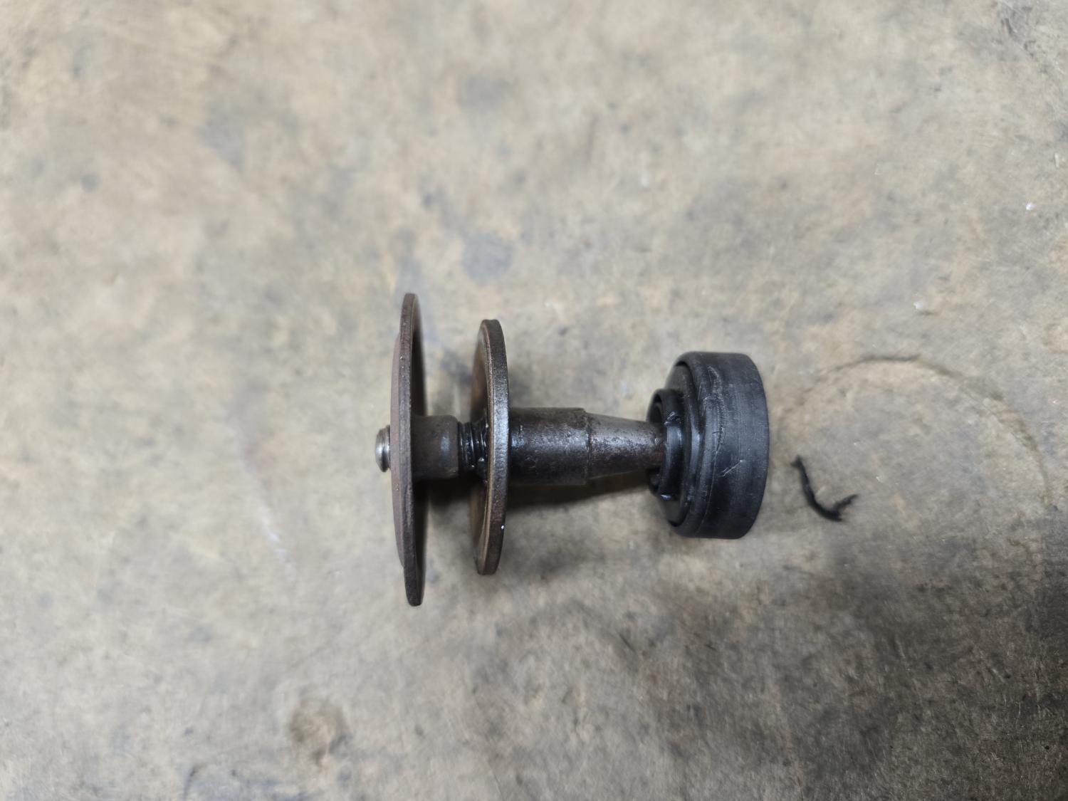

I also had to fix one of the tall stand rollers for the front window. IN the mill i drilled and taped the tapperd shaft and jb welded in a grade 8 threaded rod. Cant even tell after its plated.(last 2 pictures)
