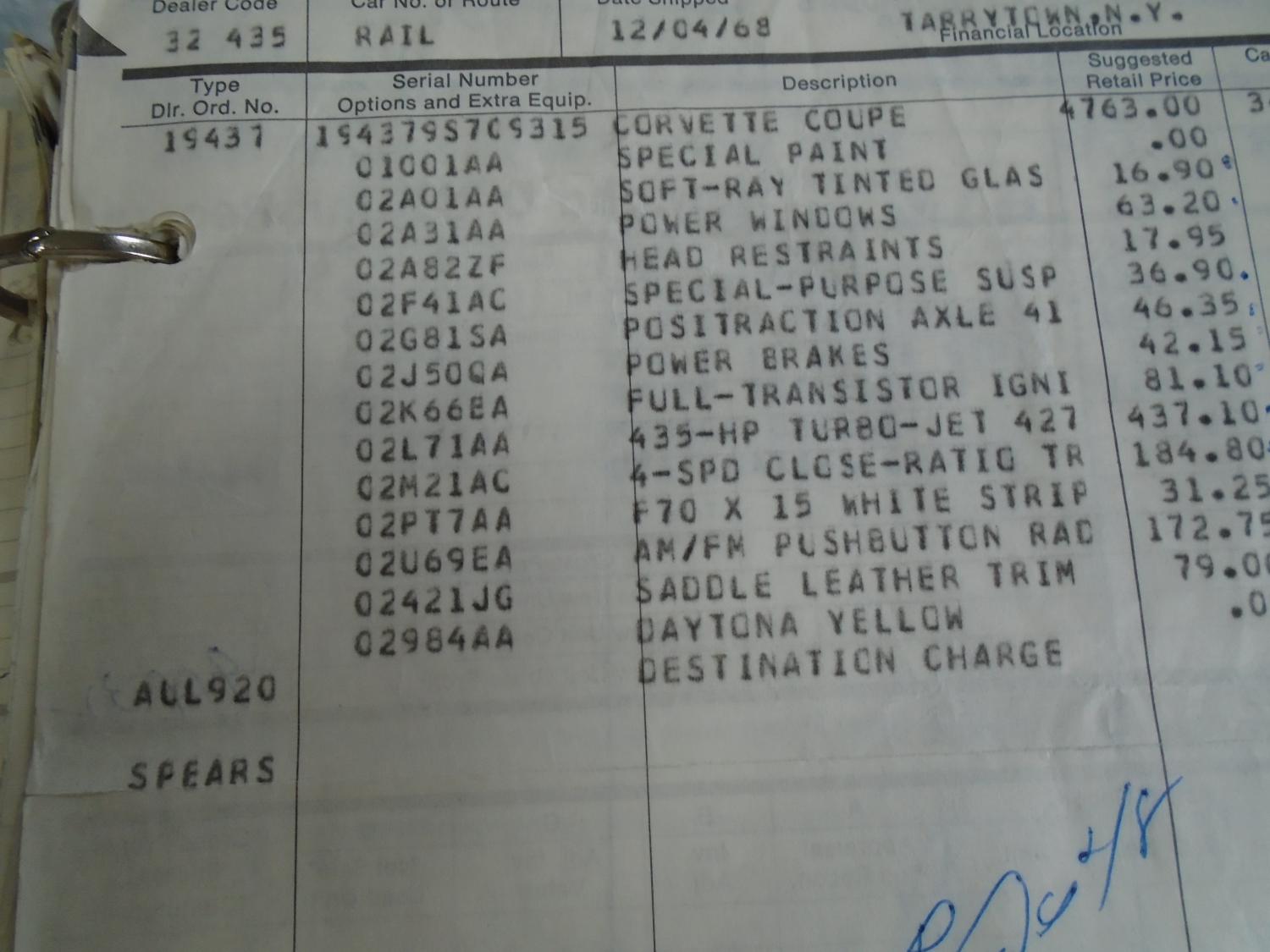

My 1969 Corvette I ordered new COPO Special paint, has my last name on the build sheet
