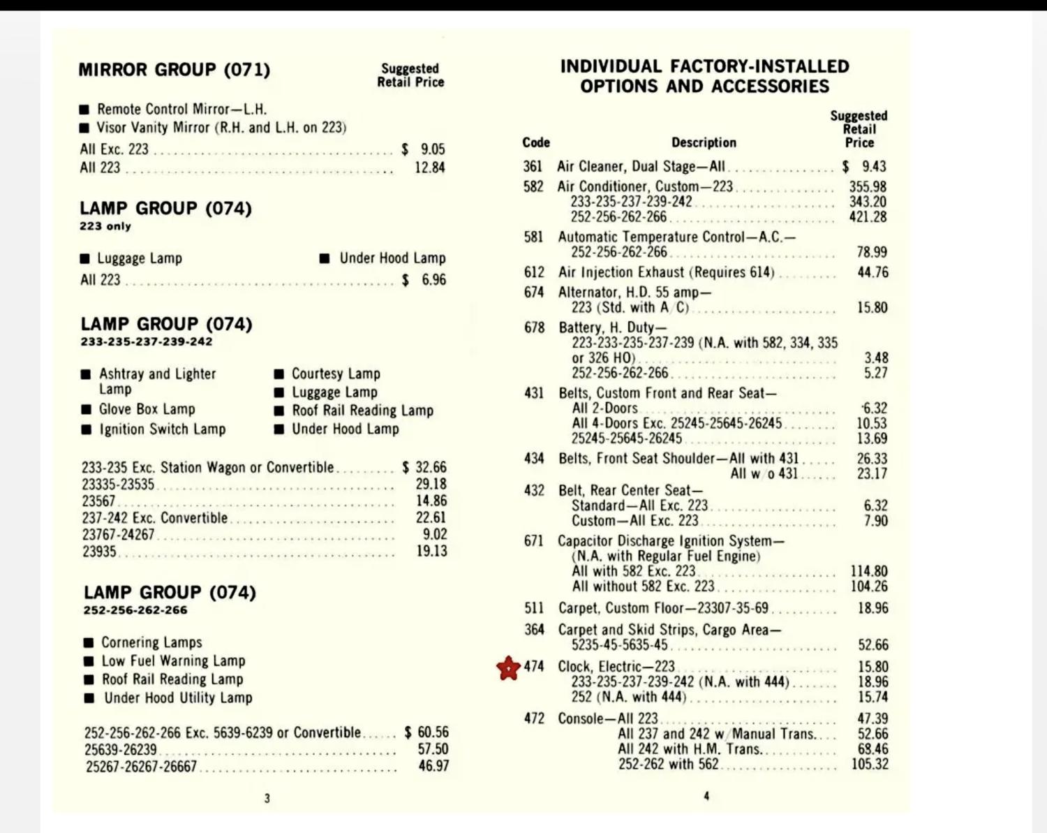

Hi Dave,
Bottom line ….. unfortunately this beautiful GTO is a mess.
Hood tach information.
First two photos are from the 1967 Accessories catalog.
Hood tach is a Dealer Install.
Third photo is a ‘67 PHS showing column 48 not having a 4 option.
Last three photos show a more in depth breakdown of how all the different gauge options were offered.
Hope that clears it some.
