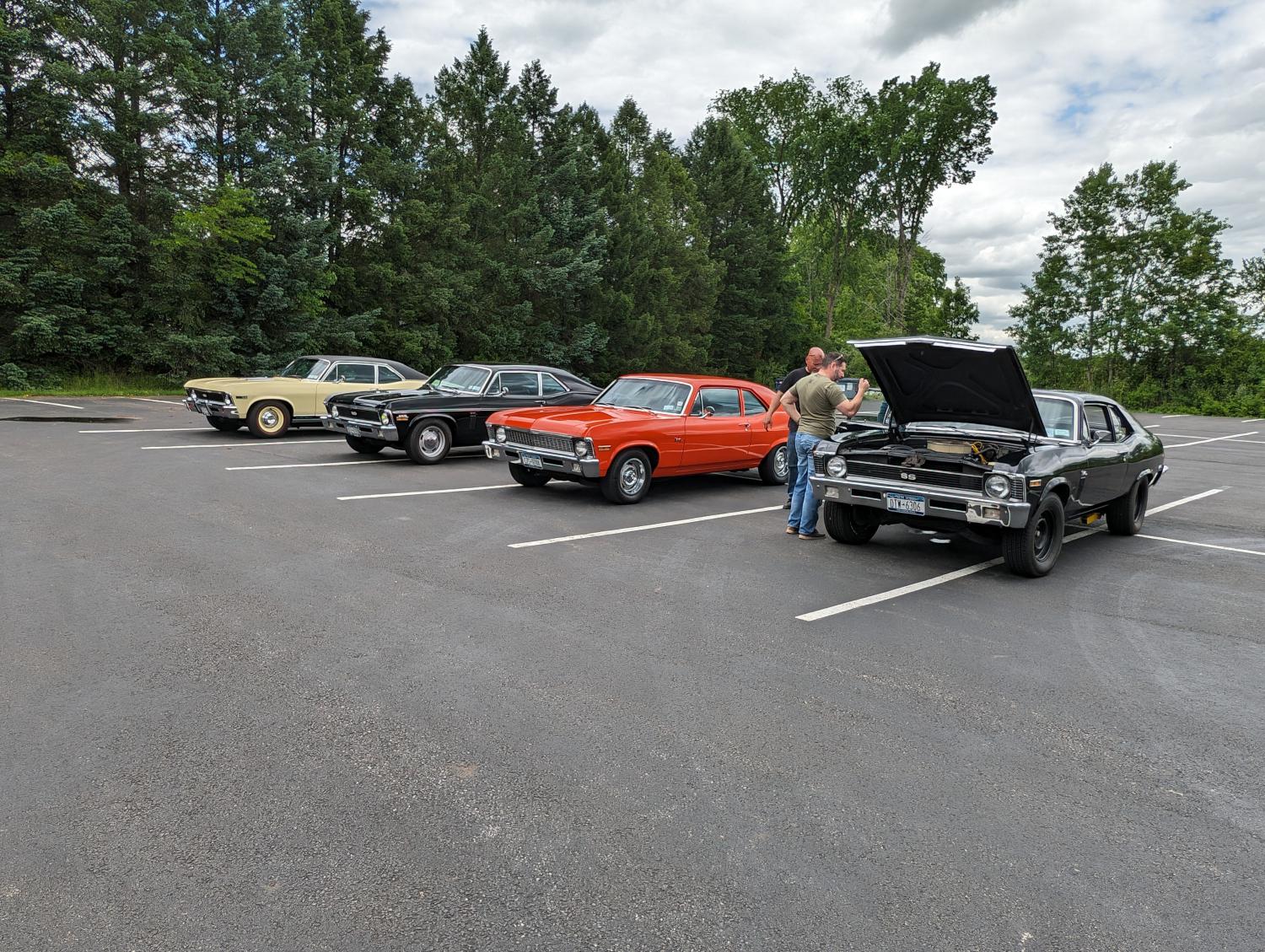

Default 14" rallys
Photo shows wheels/tires...on the orange car.
