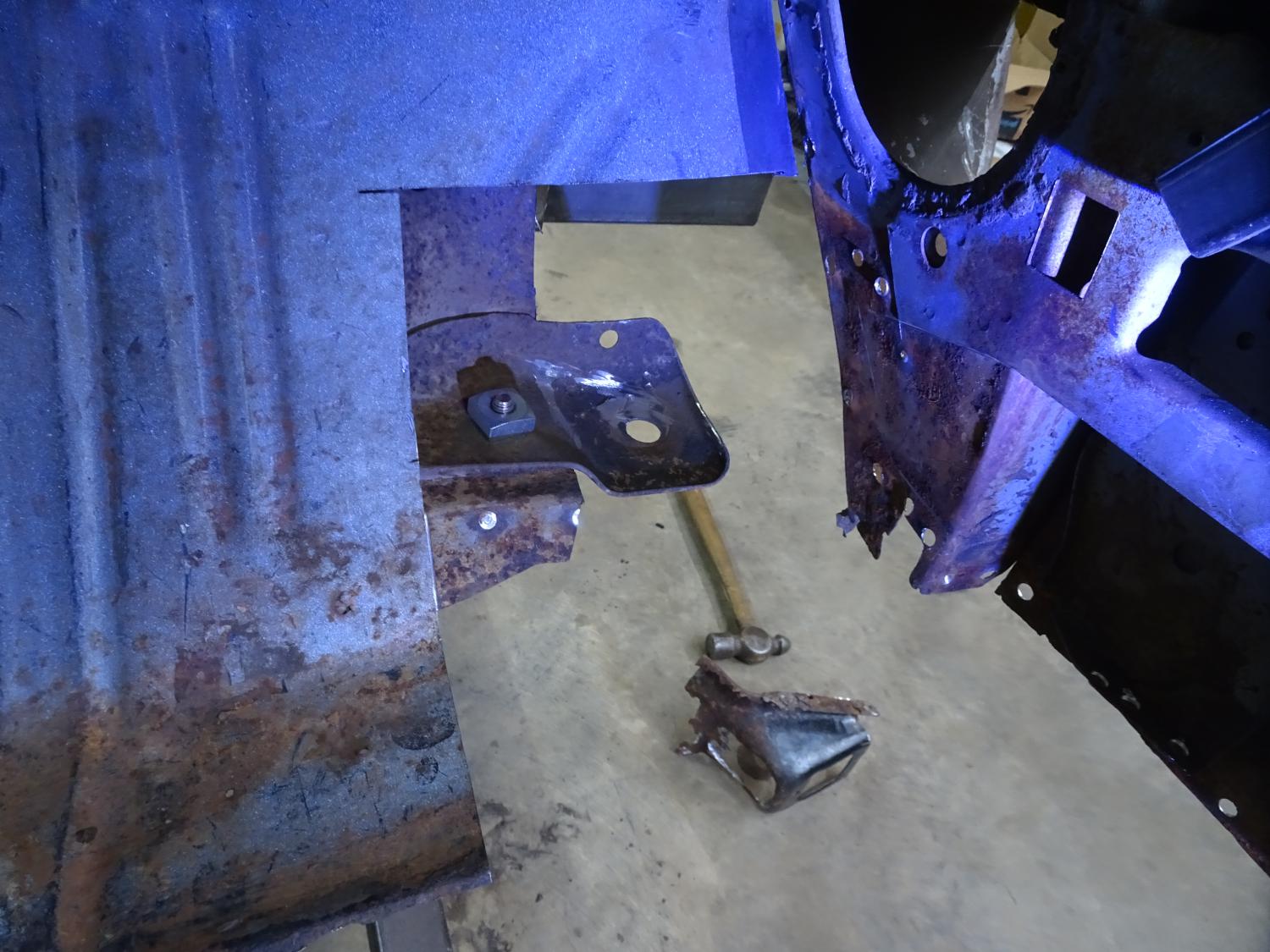

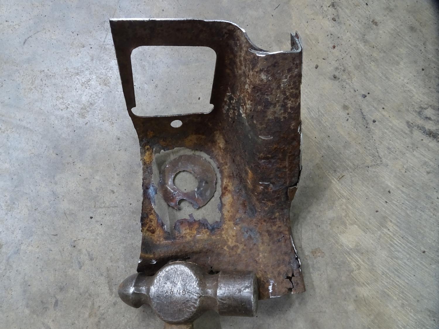

There is a plate inside the frame there for the 2 attaching bolts for the ladder bar. I will be looking closely at that when I get it out, to see if it is going up into the frame radius and stressing it there, causing the crack. It could be the car was raced and run hard, it just doesn't seem likely with the 3.31 gears, but never say never.
