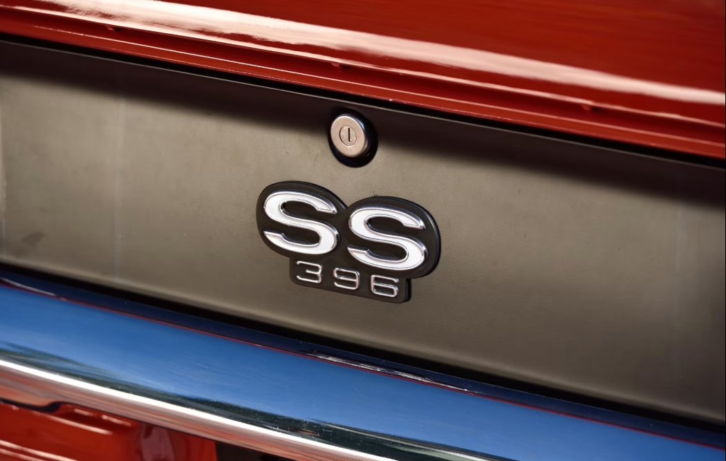

Default No idea what is going on here...
https://www.mecum.com/lots/1159642/1...aa_id=726450-0
Reported VIN: 124379N526710
From the hard card:
Original matching numbers 396/375 HP L78 V-8 engine
Engine never taken out of the car
Original retail order
Window sticker
Also consigned to Mecum Kissimmee 2016, no sale.

Must be the L78 version 327. Somethings not right
Bill
Old 10-29-2025, 11:02 PM
pdphilson pdphilson is offline
Join Date: Jan 2025
Posts: 72
Thanked 52 Times in 21 Posts
BP ---- 273 10 bolt --- goes with the 210 horse -- LOL

Whats up with that rear SS emblem

I certainly appears someone has been caught making up a car with a story to match. Probably had no idea the POP would surface one day.

Rare 1 of 1!!! Flint-built 396/375 HP L78 V-8 engine!!!

Mecum should pull it from their auction now.

I still don't understand how it's legal to sell cars like this.
Be interesting to know if the current owner bought it to remove it from circulation and hide the truth. Good thing people have a pic of it saved for evidence.
Has anyone alerted Mecum to this development ?
