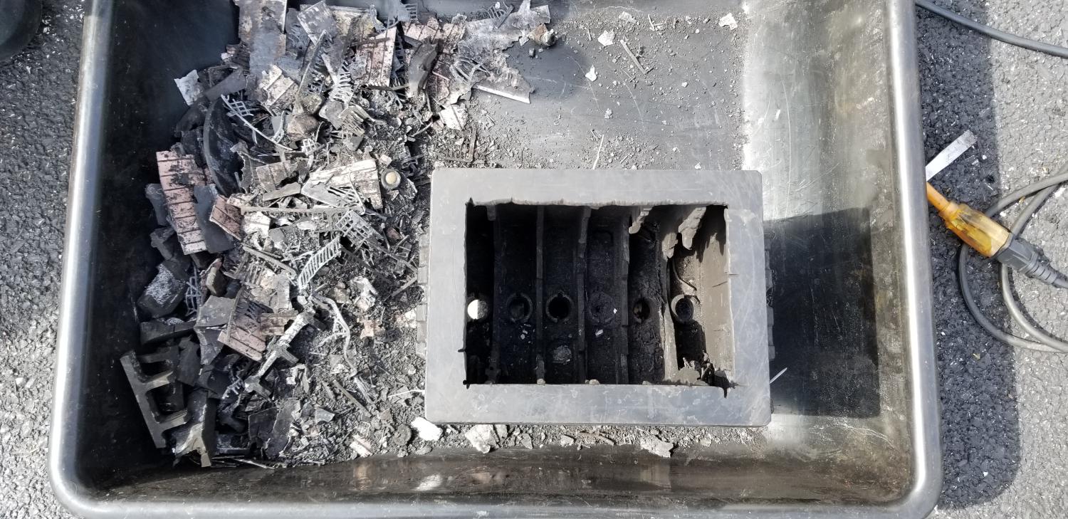

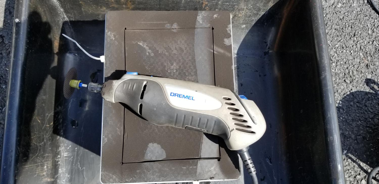

I used a small rotary cutter, running pretty slow speed so the plastic didn't melt.
I drained the battery into a plastic tub, then neutralized with baking soda. Then dissolved baking soda in warm water and filled the battery past full. Then drained and flushed. PITA chiseling all the plates out.

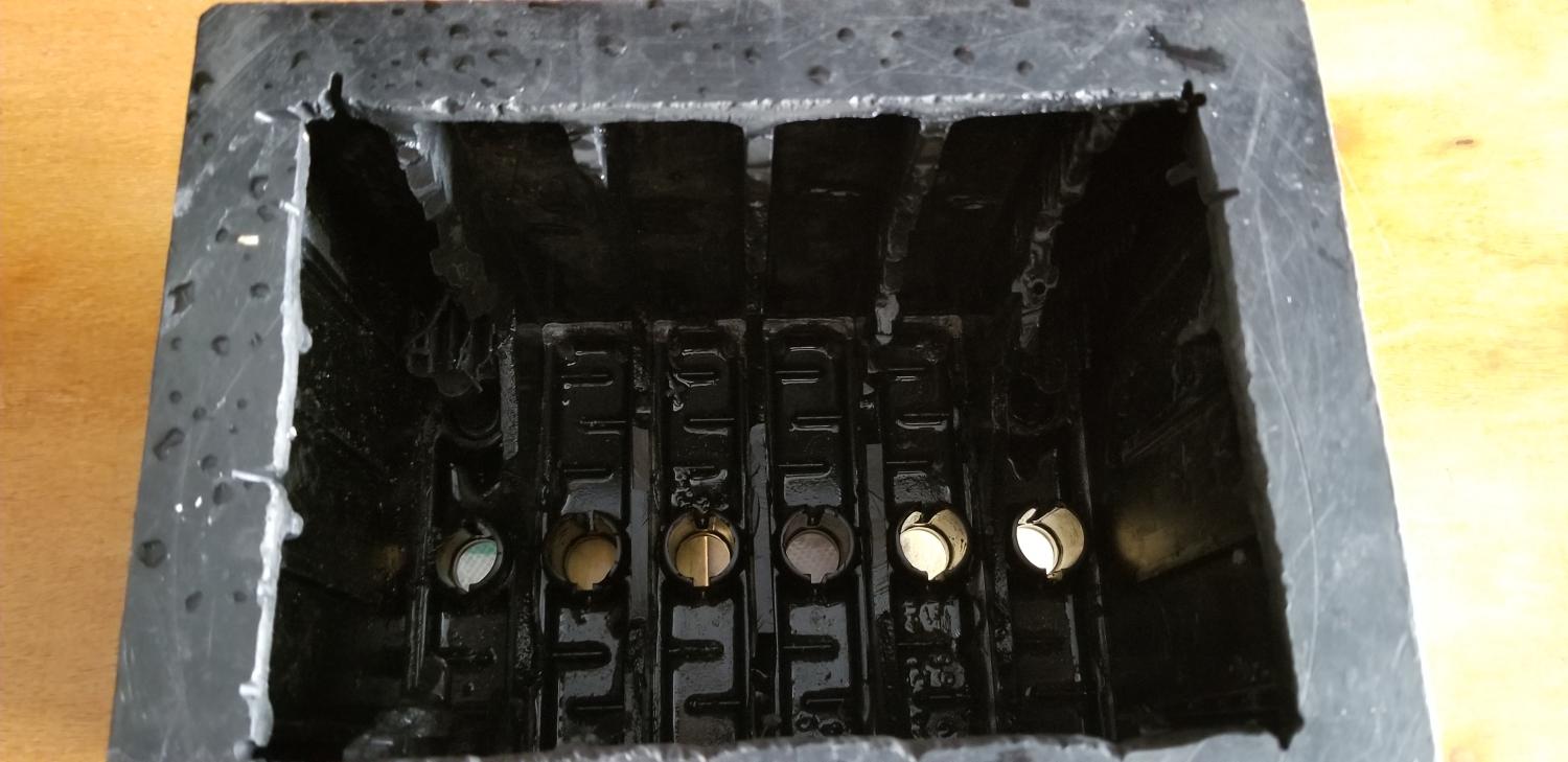

Lynn, it's a royal pain chiseling, breaking, hammering, and prying all the plates out. The case is like eggshells, too. It took me four hours of work to gut the acid filled battery.

Yes it is. I think I used a hack saw blade mounted in a compact holder to cut the braces out of the way. Getting that first cell of plates out is the worst. Gets better as you go along.

I've had excellent results with HD type batteries that have 500 plus cold cranking amps. Easy to replace also on original gutted batteries. I've gutted four and it is time consuming but never had an issue.
