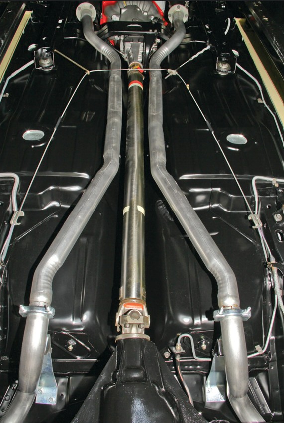

This is Chick's Z with Garner and headers.

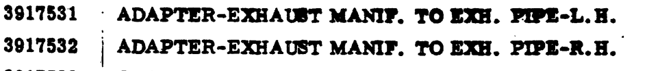

Would you consider using 3917531/32 Adapter-Exhaust Manif. To Exh. Pipe-L.H./R.H?
It’s listed in AIM UPC O C1.5. I’m sure it would have to be fabricated.
This is what I believe it looks like.

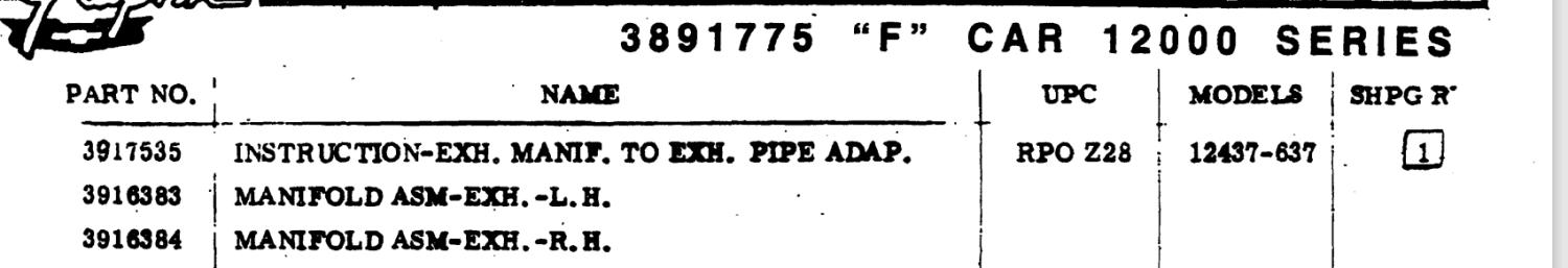

I've heard of this kit but had never seen one, thank you for posting. I found this reference in the AIM shipping manifest. The first part number referenced below if for the instruction sheet.

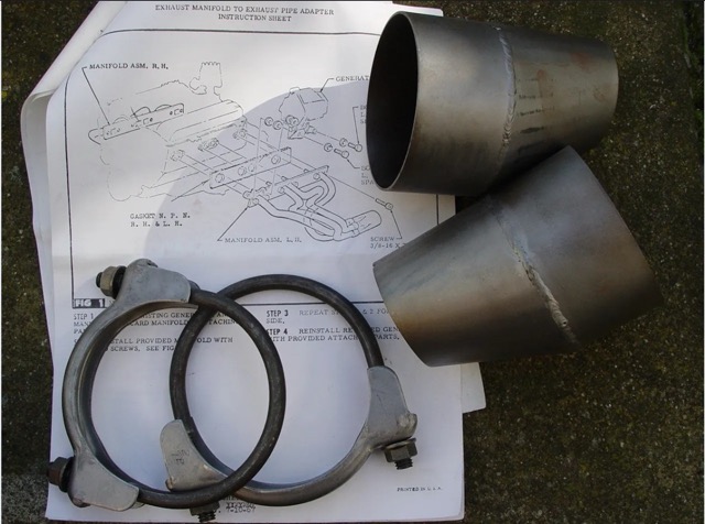

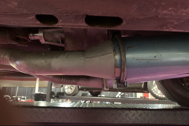

You’re welcome Paul.
The adapter pic came from Jon’s Headers post at the CRG. The installation kit was part of the Dick Lewis header package which preceded the LC headers.
The other photo showing the adapters installed is of the survivor 67 Mountain Green Z28 now owned by Chris P.
I too have a Gardner deep tone exhaust and LC headers to install on my car and will have adapters fabricated for the transition.
