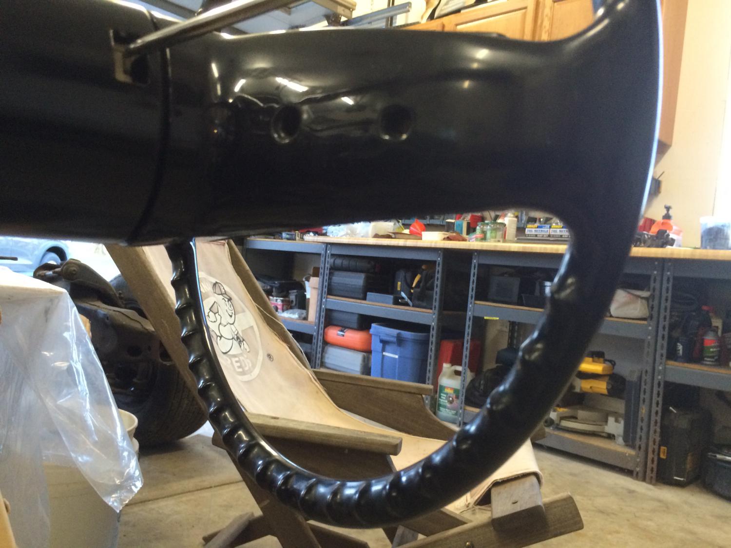

Gloss level. My original wheel and my over-restored, too glossy spare wheel

Dave (and others) How did you prep and paint your Steering Column Pieces ???
Epoxy and Aerosol, Epoxy and Single Stage Gun Paint ??????
Ive been polishing my spare wheel(s) with a 3" Micro Fiber Pad on a DA and Meguairs M105....
Works well but still has minor scratches......At this point I dont want to get too aggressive
with SANDING and wind up having to Paint.........
My Original (70 Z28) Wheel should polish up Nice enough to use without repainting, but I havent worked on it yet.........
