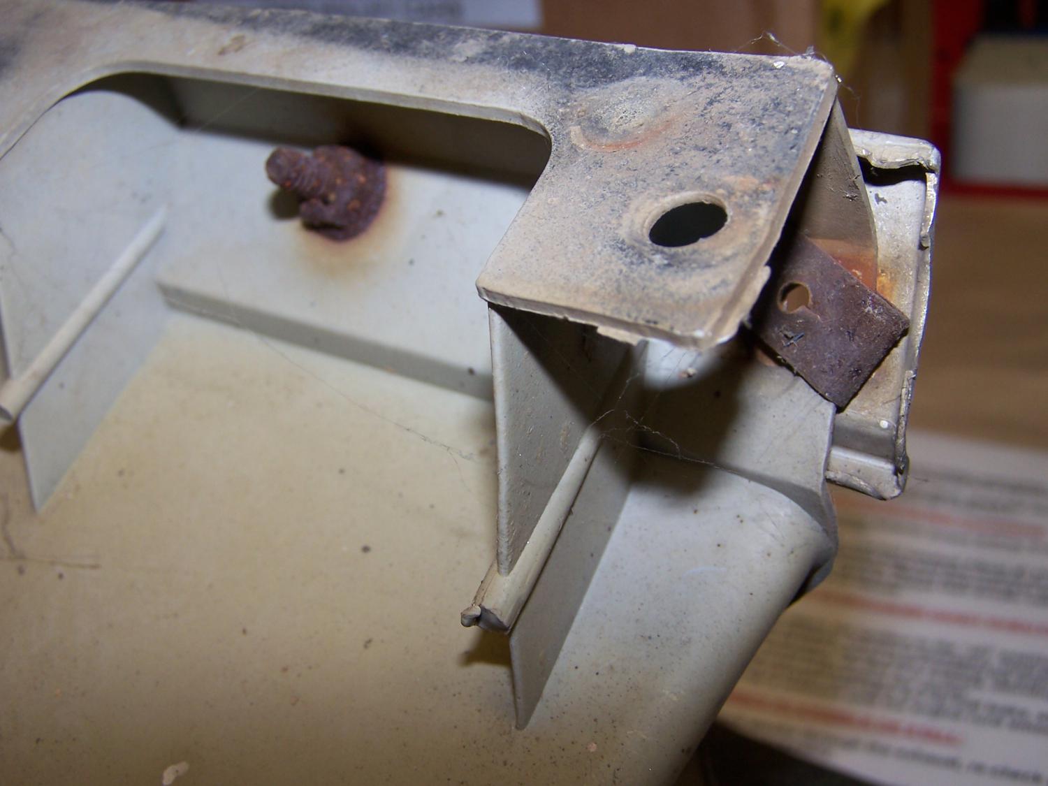

here is a photo of my LOS Std lower hardware:
UPC 11-13 Sheet A6 Item #6 (9419841)
For Lower STD grill trim to Plastic center Nut used on trim 10-24 stud.
Phosphate stamped Nut, for a machine Thread..
AMK # B-13383 (#10 HX FLG PALNUT PHOS) 10 PCs.
GM Grill Factory & NOS both photos.
(Note Rev #1 Symbol it WAS a rivet and Engr Change Dated Nov 1967, I wonder if they had problems installing grill>?)
