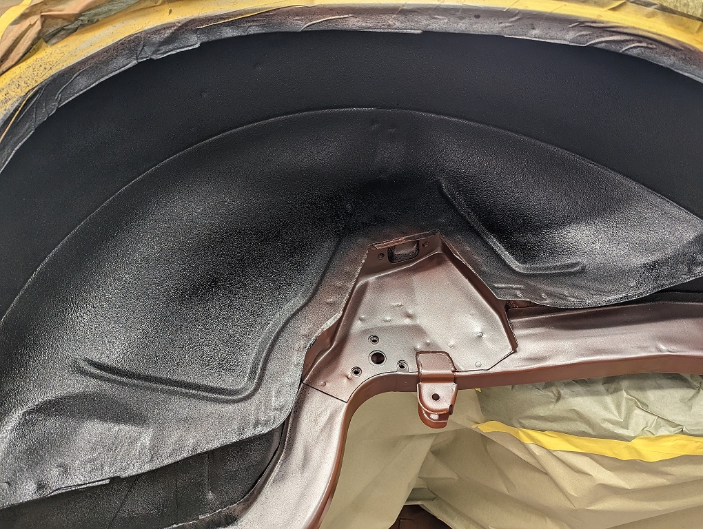

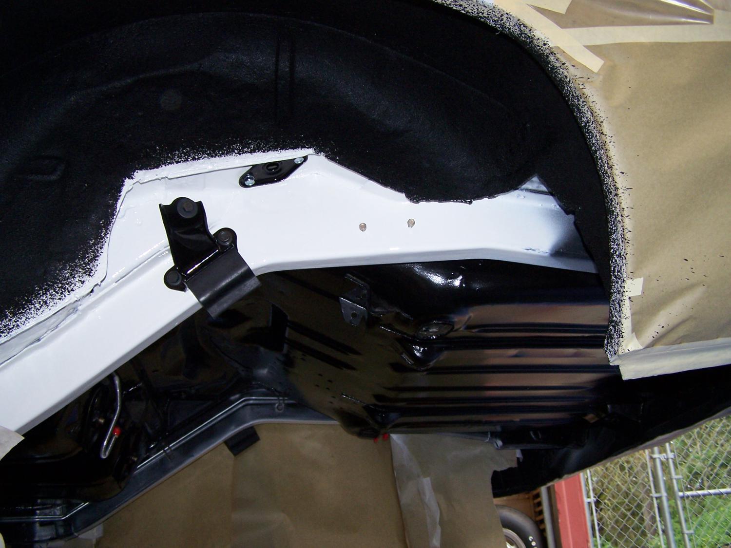

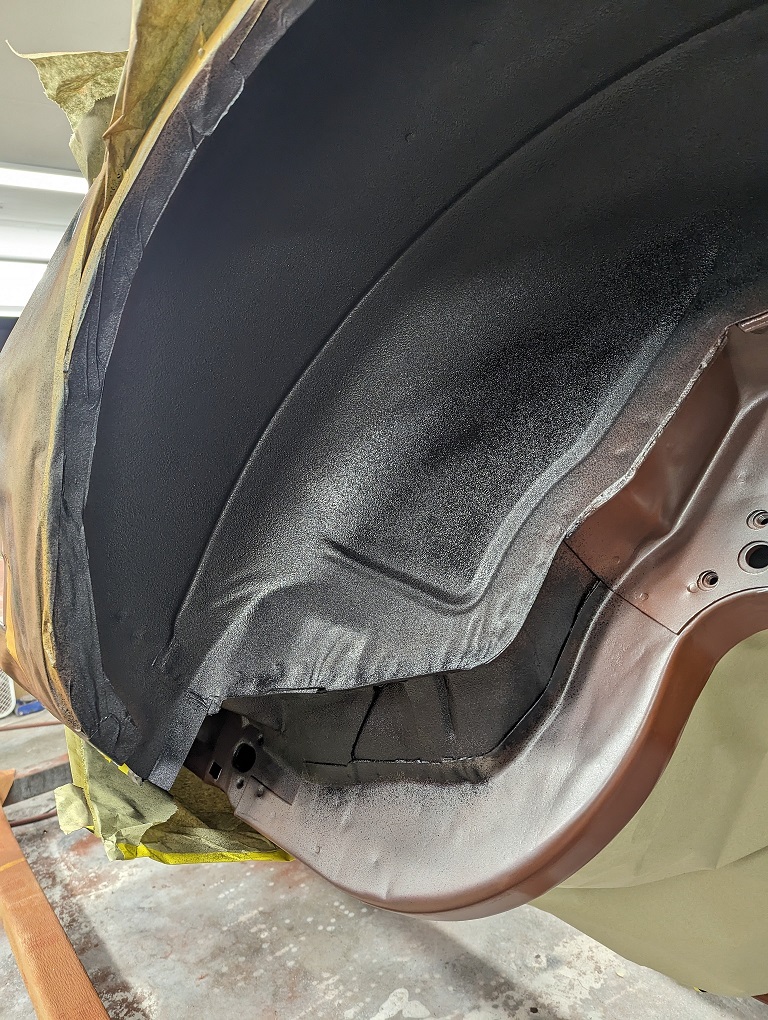

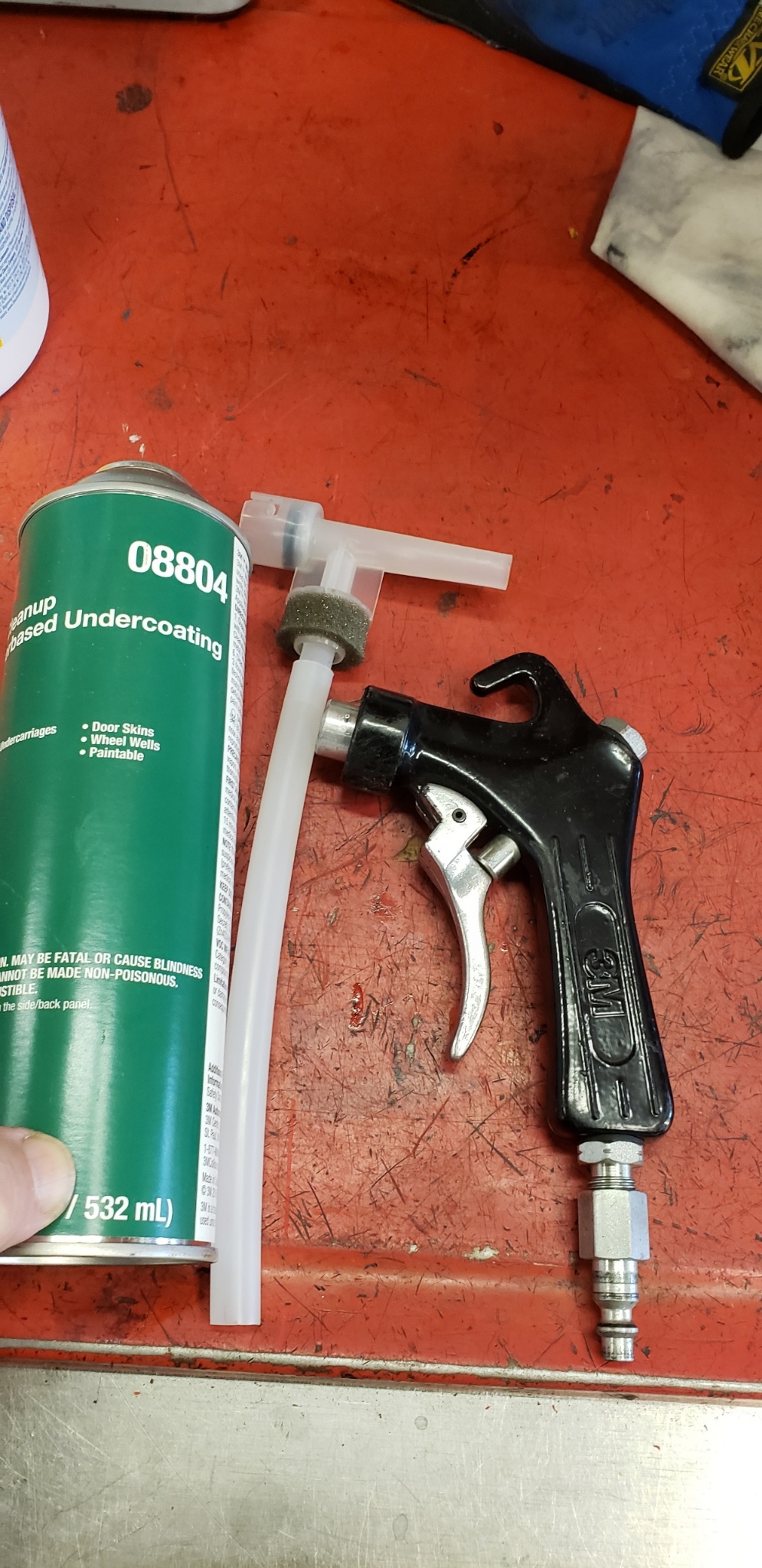

7100070546 (Summit) is 3M # 08864 Body Schutz
I really liked this comb as I could adjust the spray/out appearance via Air Pressure, Distance, & Speed and layers can be added.
It does take a fair amount of time to tack and fully cure.
