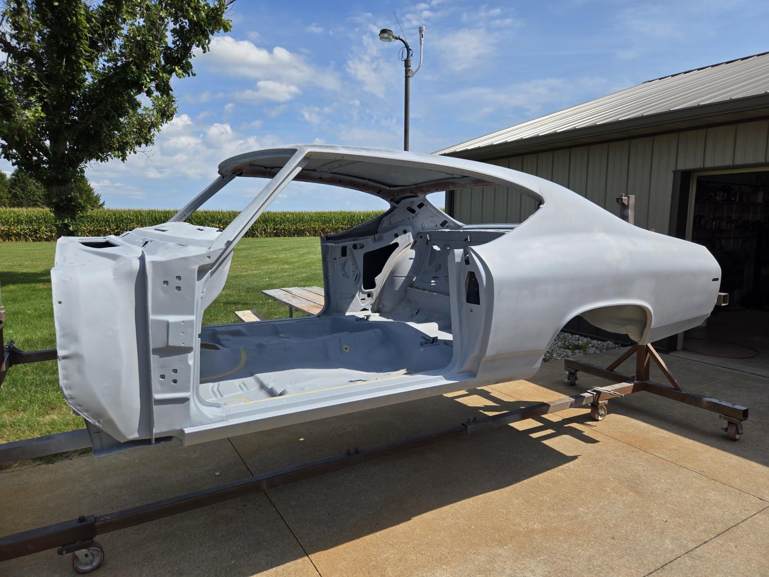

Default ON The downhill for Bodywork

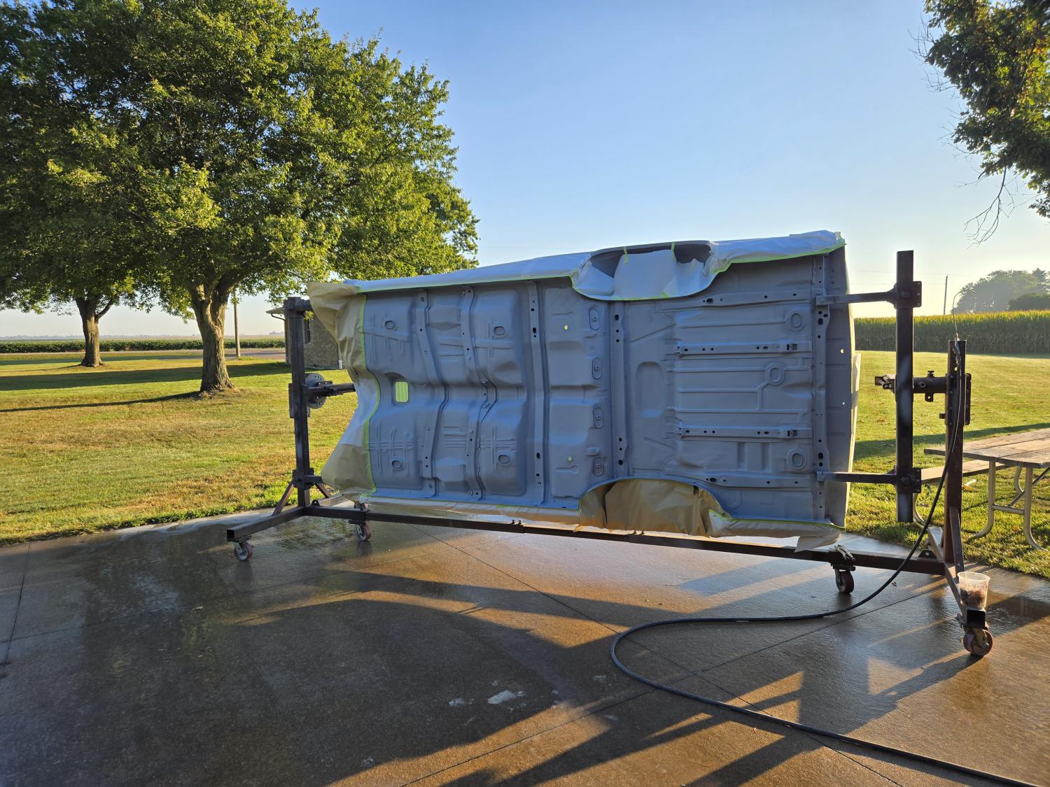

Body is finally complete. Seam sealed and guide coated before paint. First step is chassis black on the floor pans. Seam sealing items like the doors and trunk. Should be putting down edge paint next weekend.

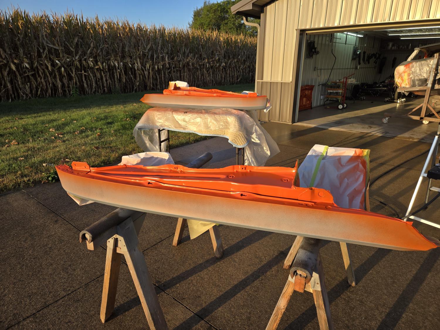

Default Firewall and Decklid
Good morning for paint again. Completed the firewall. Deck lid got base clear. Color is vibrant and stunning in the sun.

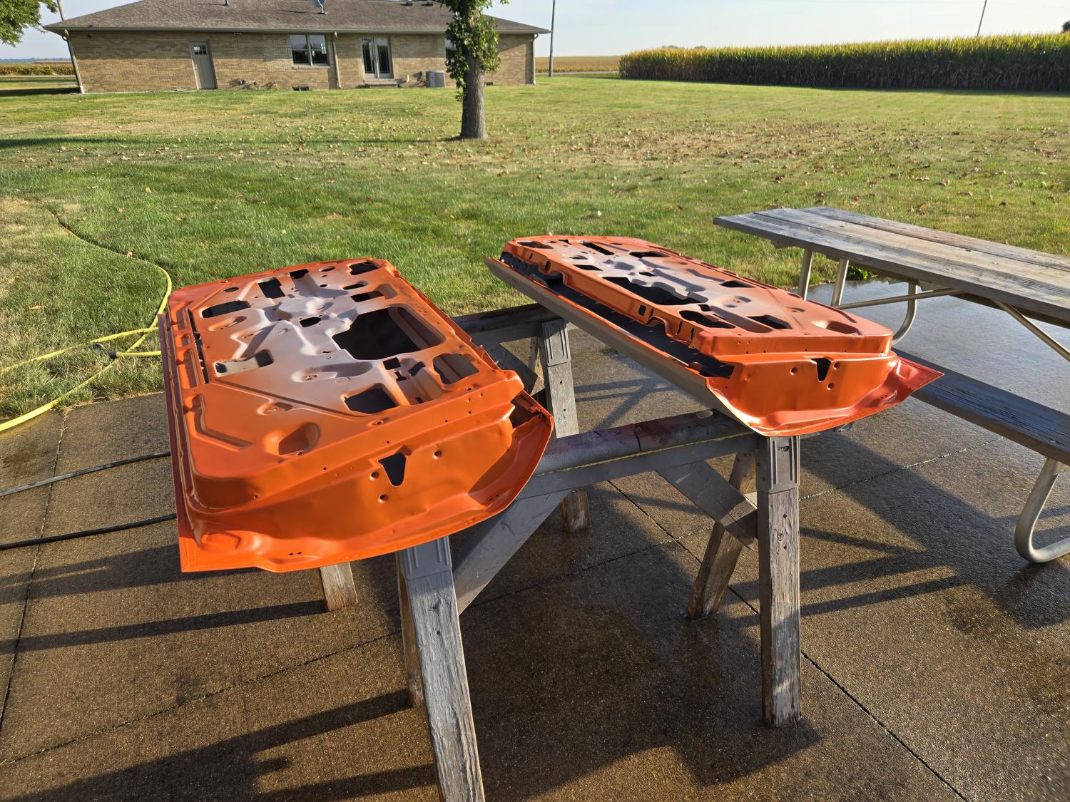

Default Fenders, doors, and Trunk
Inner fenders got chassis black. Doors in the first pic are just base coat, and then cleared the next day. No bugs, it was a good day. Body got edged in the trunk area. Next weekend hopefully jammed in the door and roof area.

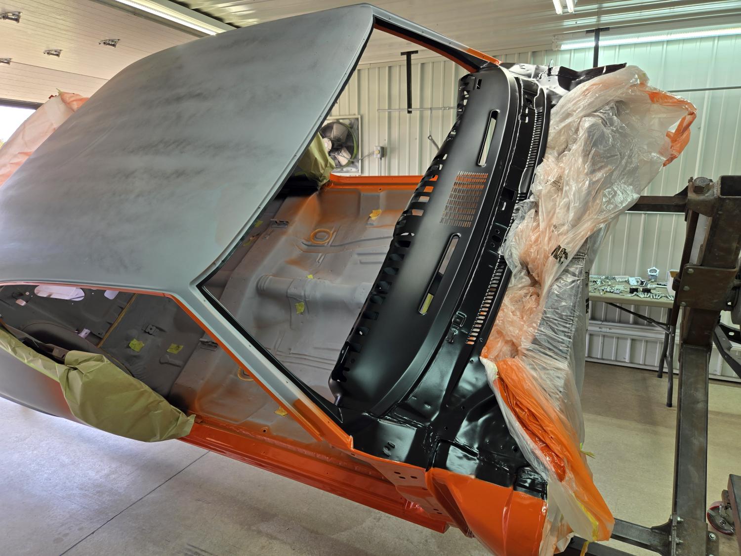

Default Trim Black
A little humid but managed to get the trim black painted around both windows and the dash. Get to finish the body next weekend with trunk paint

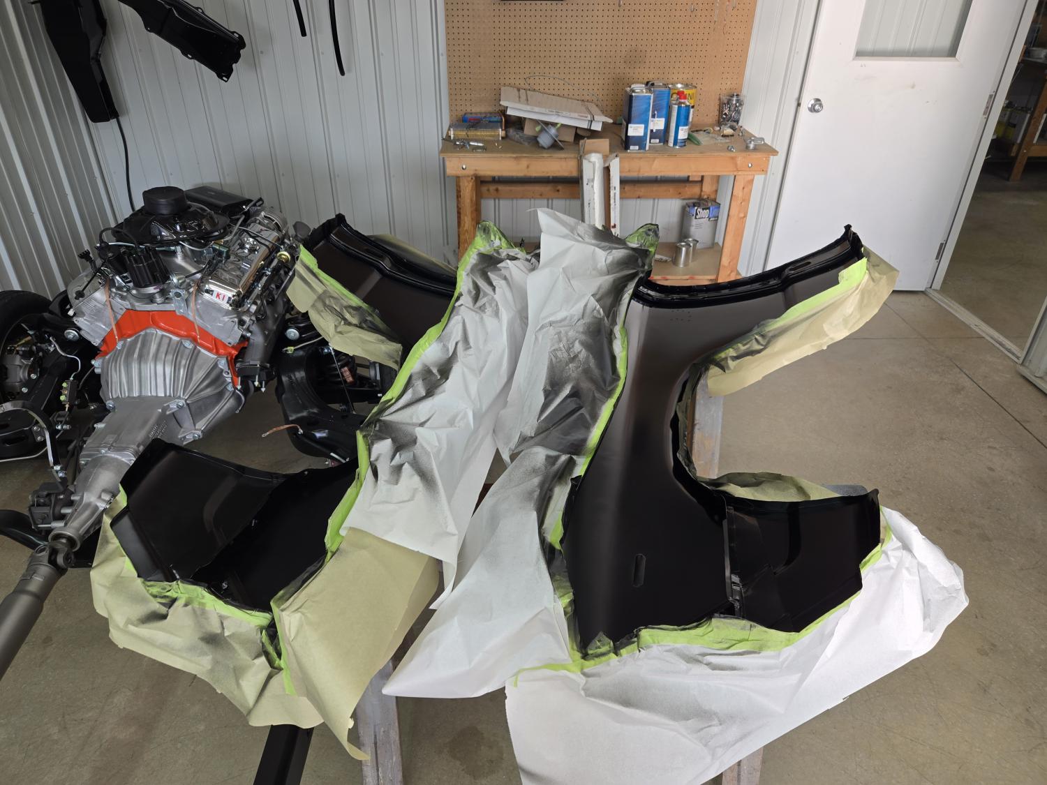

Default Front Fenders
Body color on the engine bay side. These are finished. No more parts to edge at this point. Next time the spray gun comes out is for the final paint of the body.

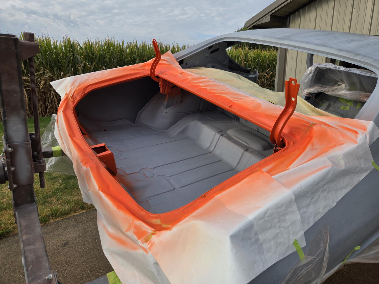

Default Body Complete, Trunk Paint
Body is finally complete. Layed down a base coat before trunk paint, and then did the spatter finish right after. Body was unmasked and cleaned up.
