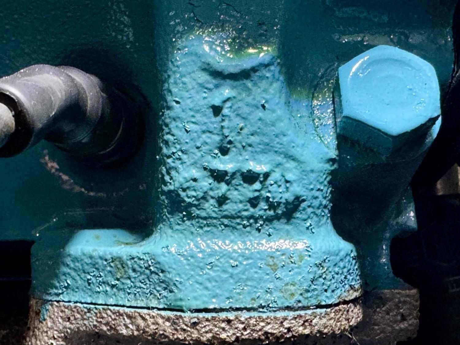

New photos have been uploaded showing engine components.
WS = Tri-Power (360 HP), manual shift.
Block date = very close to build date.
Cylinder heads #77 = ‘65 GTO.
No, this is not a Survivor as advertised as it does not have factory paint.
Still don’t know if transmission and rear end are born with ?
Power brakes were recommended on cars with metallic brakes such as this car.
At some point the Power Steering was added as it’s not noted on the PHS Billing Card or the Window Sticker.
If this car is a legit matching numbers GTO it would be a highly sought after example because of all the performance options noted.
PS, One year only (1965 GTO W/3x2) HD 4 row radiator with filler neck on RH side with matching fan guard.

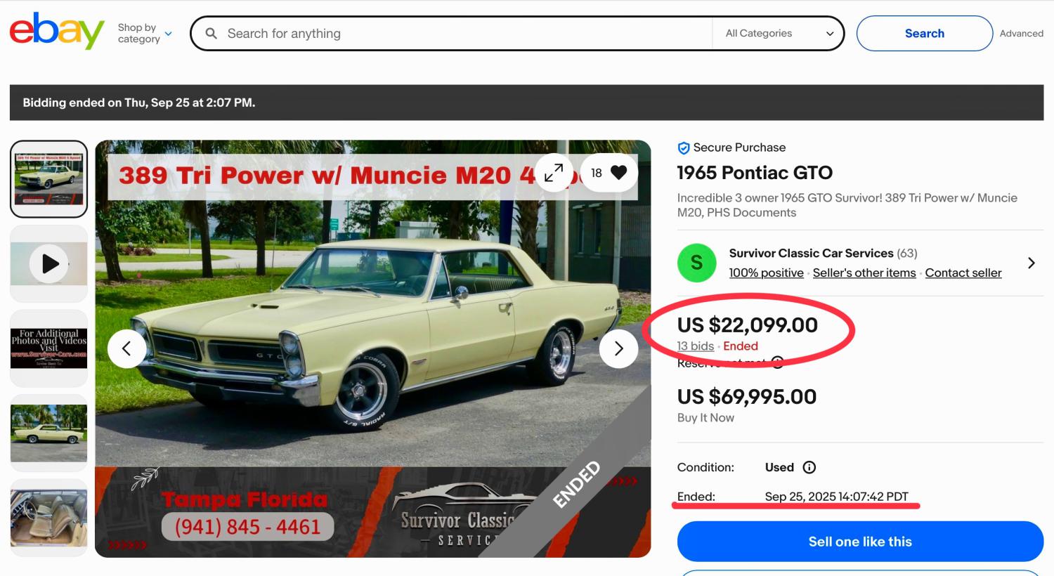

Huh ??
Either something is drastically wrong with this ‘65 (major rust in body / frame), the seller, or terrible advertising.
In stead of 100 photos of the exterior this seller should have documented with photos the completed powertrain (all engine numbers, transmission numbers and rear axle codes), plus pull a brake drum to show the metallic linings.
Put back the factory ordered black wheels with standard hub caps, red line tires and correct the stance.
Complete Gardner exhaust.
Thoroughly clean / detail the interior.
Sort / correct engine bay.
You would have a damn cool ‘65 GTO..

----Wow! I would have argued the 70 grand, but 22 thousand,,,WOW....Bill S
