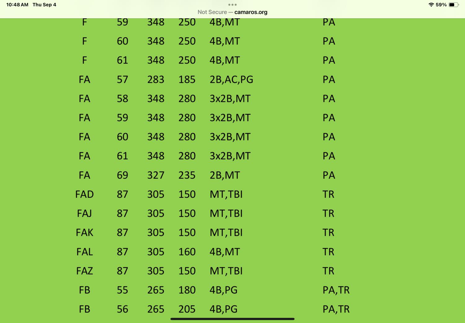

Default FA code engine
Not sure where you’re getting your information as to the “FA” code but see attached from the Lime Book
[email protected]

Originally Posted by scuncio View Post
ID is the 427-425hp suffix code for a '66 full size Chevrolet.
Yes, that. Not FA
