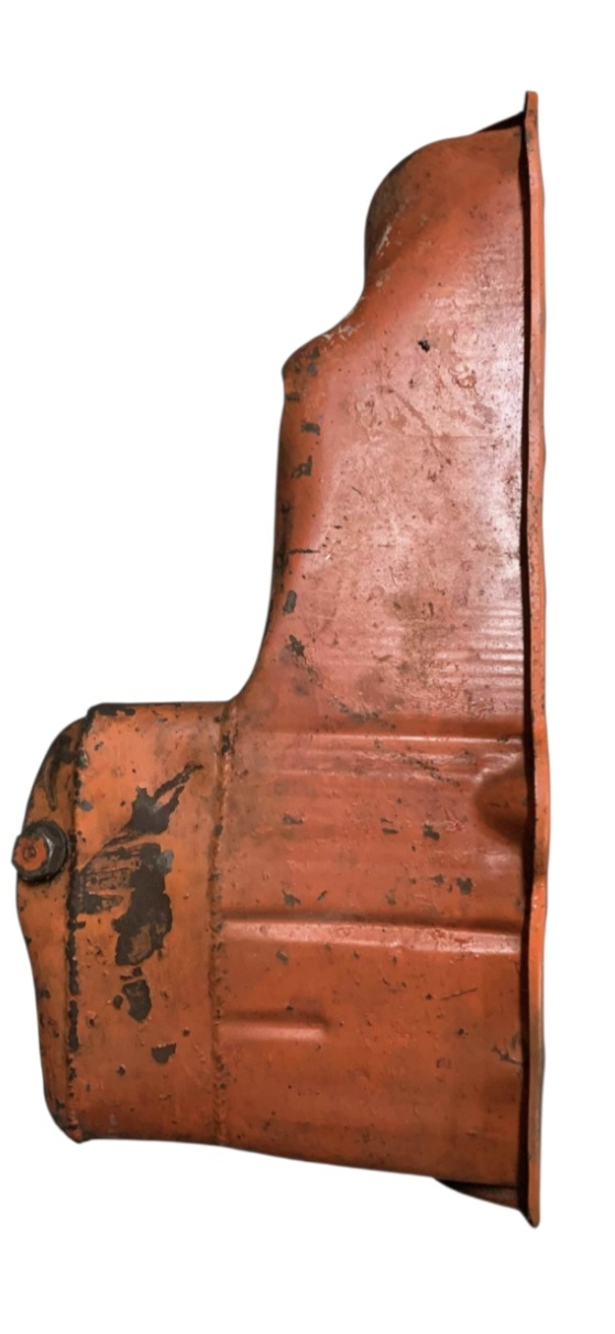

Any chance this is a over the counter gm pan simular to the l88 pan ?

Yes

No, it is not! The factory deep sump oil pans have only one weld line going around the sump. It is close but not exact. Impala pan modified by owner by adding a strip of metal between the sump and the upper part of the pan.

That looks similar to the pan that I made for my car many years ago when I couldn't afford a deep pan.
I believe this oil pan was fabricated by someone.
