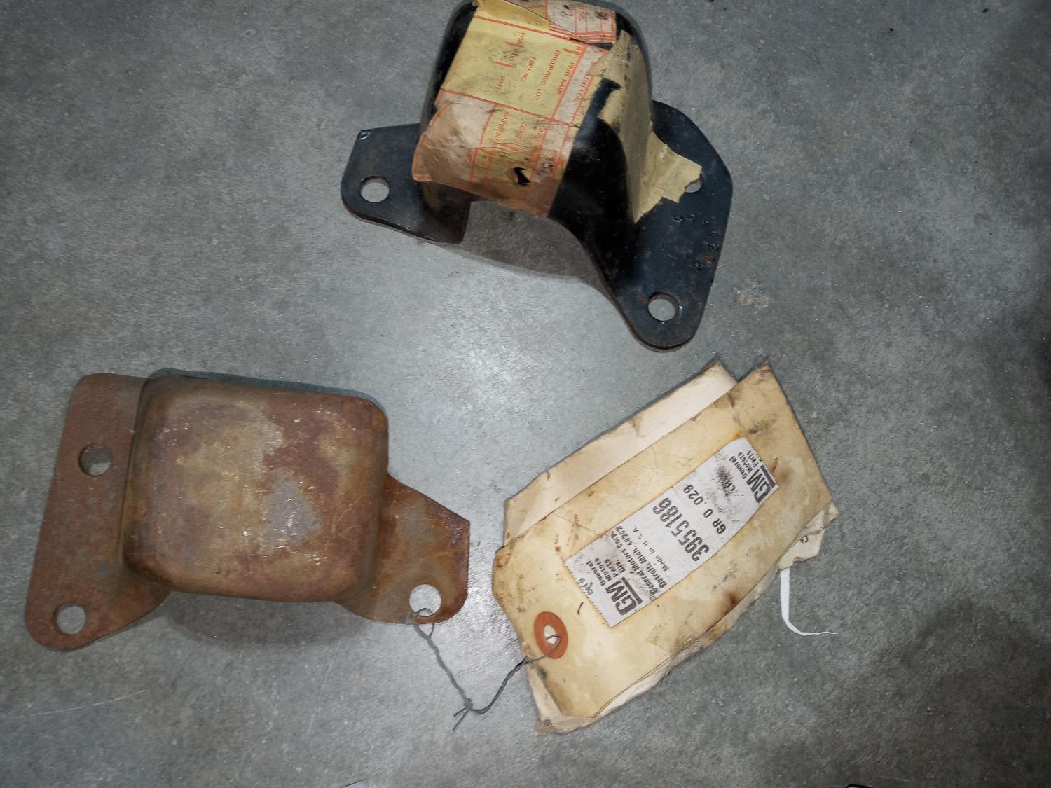

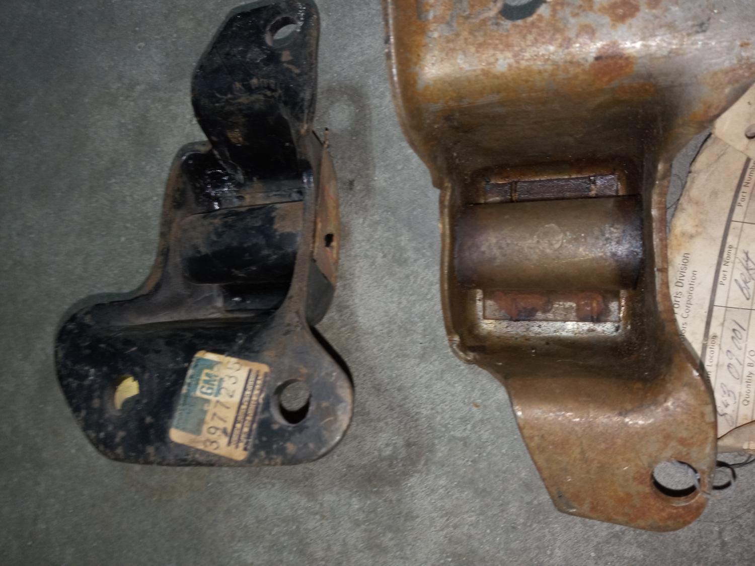

I have these 2 Nos engine mounts. One is part number 3955186 the other 3977235 Would anyone know what they are for

69 parts book list 3955186 as 67-69 Passenger (350,396,427) Right (left is 3955185)
70 parts book lists 3955186 as Passenger, Station Wag, Taxi, Police (350, 396, 400, 427, 454) Right
70 parts book lists 3977235 as Passenger, Station Wag, Taxi, Police (350, 396, 400, 427, 454) Left
Greg
