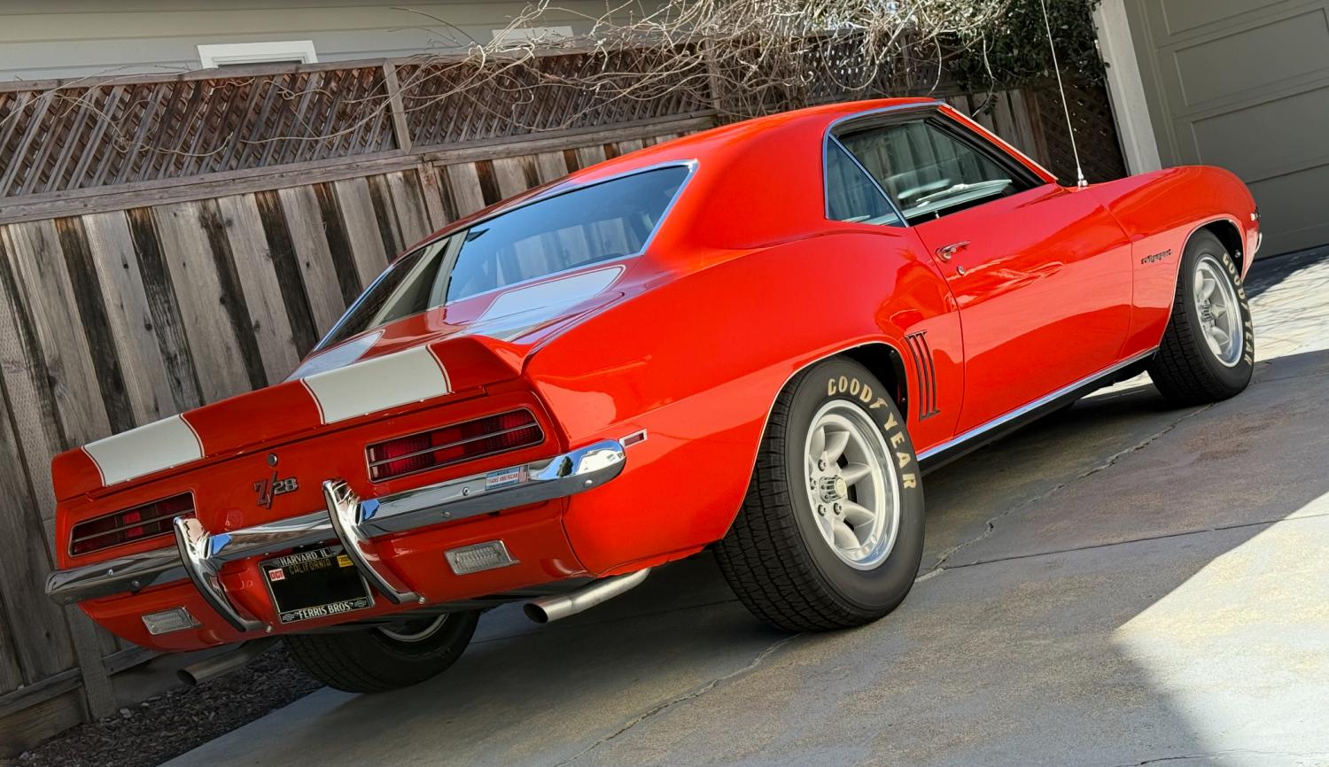

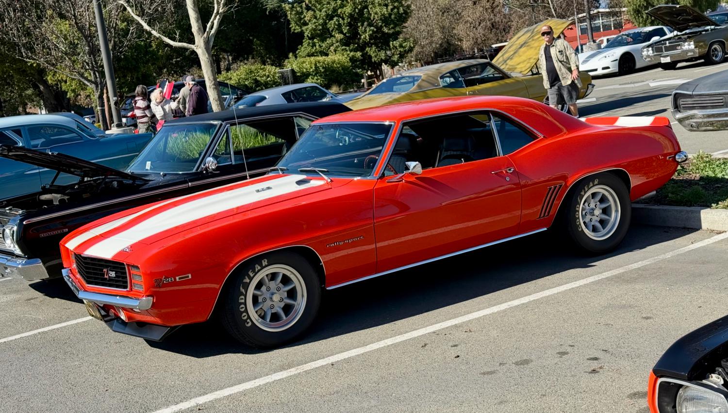

I recently sold the wheels and tires.
This is from the description when I had them listed.
Rears are 15 x 8.5 with 5 inch backspacing. As you can see from the pics they fit perfectly under inside the wheel wells of my 69 Camaro. I cannot say if they would fit inside a 67 or 68.
Rear tires are 255 60 R15.
Fronts are 15 x 7, also 5 inch backspacing. I ran a .200 spacer (very easy to find) to keep them from rubbing the frame rail on full turn. No rubbing issues at all. Although I am normally not a big fan of spacers, but .200, or even .250 isn’t excessive and I had no vibration issues.

Thank you, they look great!
