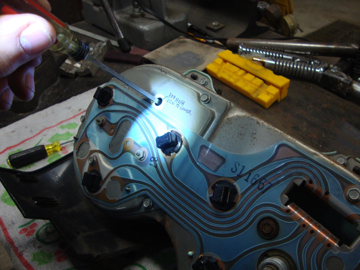

Jose,
Sincerely, ! Thank YOU !
We Just Adjusted Johns 67 Tach! successfully. Using your TIP

Originally Posted by 169indy View Post
Jose,
Hey glad my post helped but I just followed Jason's @SuperNovaSS tip. Looks like Johns tach needle may rest a tad above zero like mine.
