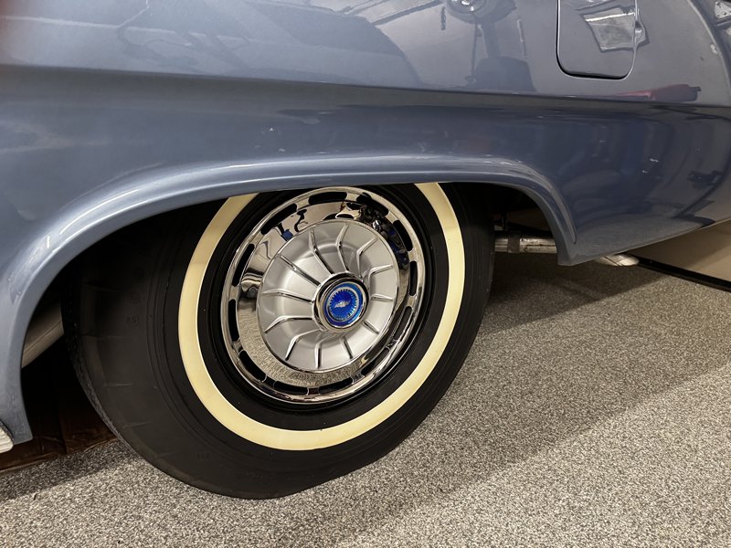

Got some more work done today...
I was able to install the rear hubcaps on both sides, I was able to install them without using any tools or rubber mallets, so that was a relief. I still need to do the final install and set the front wheel bearing dust covers before I install the front hubcaps - hopefully this week. I fixed the oil leak - when I changed the oil and filter last week I must have fubar'd the gasket as it was mangled. I relocated and tightened the radiator hose clamps and those leaks seem to have gone away. The VIN tag on the door jamb was painted over when the car was restored so today I used some paint stripper and got that cleaned up correctly.

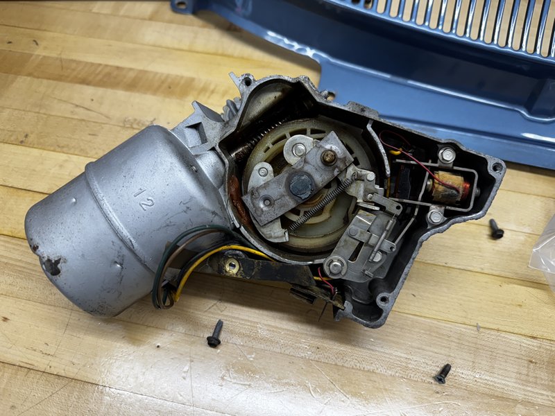

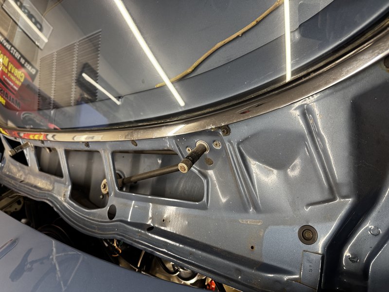

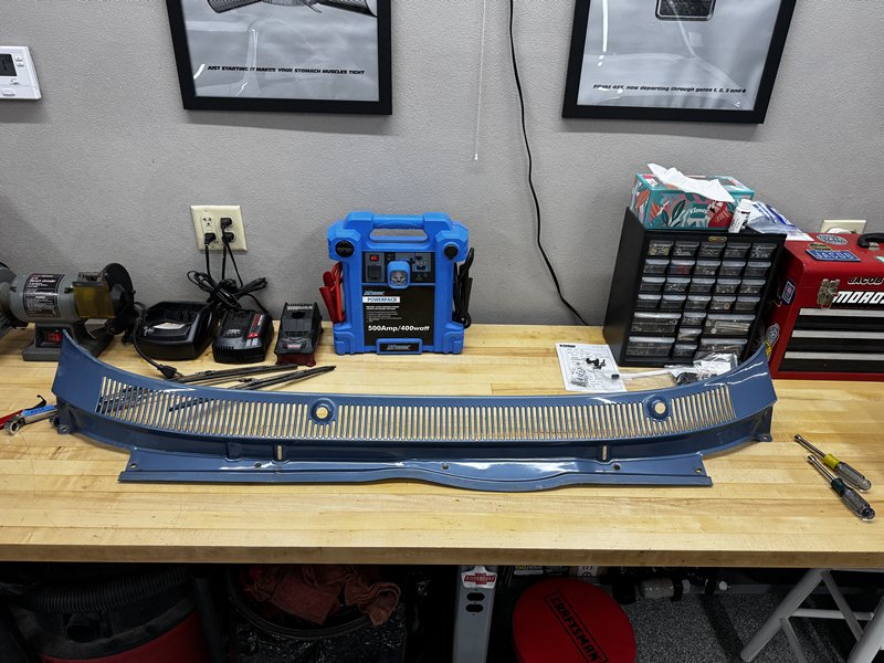

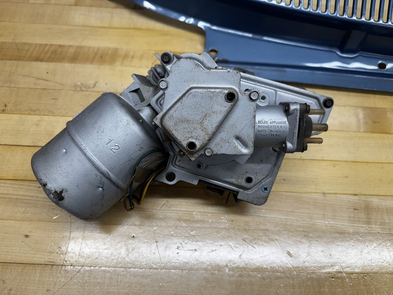

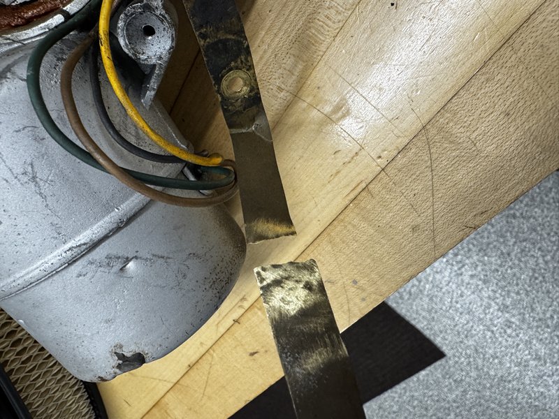

Big project today was getting after the windshield wiper motor/washer pump. In order to remove the motor/pump you have to remove the wiper/cowl cover which takes some time to do. The pump was not working so I bought a rebuild kit from Corvette Central (these motors/pumps are the same as mid-year Corvettes) but when I removed the motor and pump assembly I could tell Bubba had been in there as the whole thing was rattle canned silver, and the flat copper ground strap was broken (I may have done that on the removal ) so I will get it sent out for a complete rebuild/restoration next week. Good opportunity to polish up the area under the cowl cover as it was pretty dingy. I'll keep plugging away on these smaller detail items until the list is knocked out. I'm going to keep it at my place this summer and put some miles on it so I can get things dialed in.

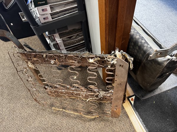

Not a whole lot new to report but thought I'd share an update. As is the case with these types of projects there are always ups and downs that are a part of the process. I took the car back to the upholstery shop to install the restored Impala only seat trim. Previously it was thought that the reproduction trim brackets I sourced were incorrect, so I tracked down some originals and restored them. Turns out the brackets don't appear to be the issue........I am starting to believe the Impala seat frame hinge bracket (that connects the back to the bottom) may have a different bend to it than the Biscayne seats. The trim bracket should be on the outside of the hinge bracket. The bench seat frame I used is from a Biscayne and not an Impala - as everyone said they are the same other than the trim brackets - and there aren't exactly a surplus of any of these in usable condition out there.
Doesn't make sense to me that GM would make two different seat frame hinge brackets, but maybe.....? Anyways, the trim is still not installed as I search for a solution. If anyone here knows please feel free to reach out and let me know.

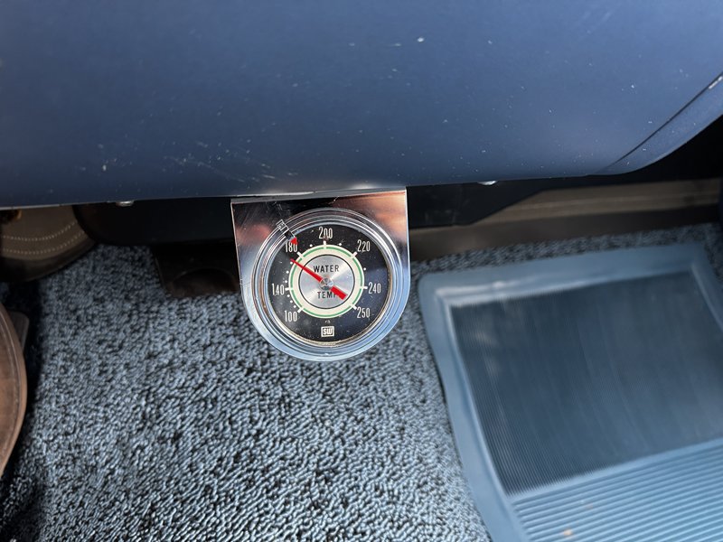

Good news is that I am putting some miles on the car ............with the cool spring air the car runs significantly cooler than it does in the summer heat. I've got a 160 thermostat installed and with 40 degree outside air today it runs just about 170 in traffic.

In regards to the seat trim issue, Jody Anderson had a pair of Impala seat backs in his inventory, I received those today and dropped them off at the upholsterer's to strip down so I can get them blasted and painted. The brackets are noticeably different so I'm thinking we've got that problem solved, just need to get them cleaned up and get the seat backs swapped out. Sounds easier than it will be (just time and some money) but fingers crossed there.

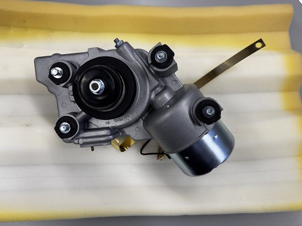

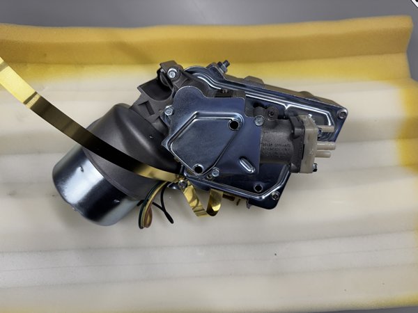

The wiper motor showed up today from Steve Hackel - jewelry for sure. Will try and get that re-installed one night this week.

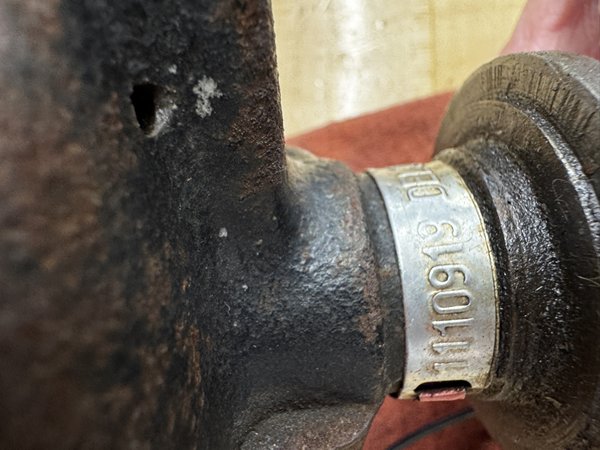

Since the carb's were off it was pretty easy to yank the distributor and make sure all is well there too. I will clean it up, make sure it doesn't need re-bushed, and put new points, rotor and cap on it. Having the distributor out makes the wiper motor re-install a bit easier too...
Good thing is the carb's are the correct numbers (3361/3362) and dated appropriately for the car - they might even be the originals. The distributor has the correct 1110919 tag. I assume the date of 1 L 9 translates to December 9, 1961? That lines up for this January of 62 assembled car, so that could be the original distributor as well.
