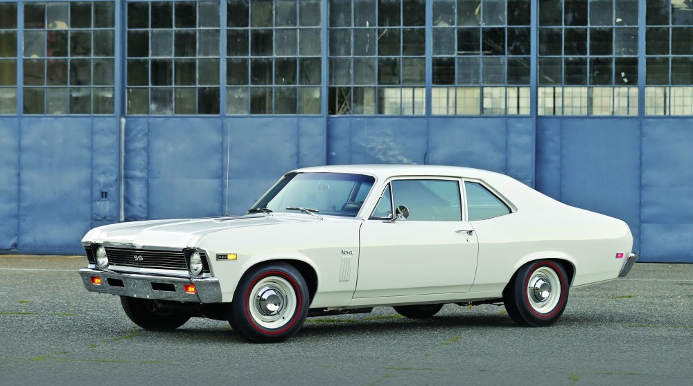

for what its worth, here is the original driveline in my documented 24,000 mile '69 L78/M40 Nova before and after I restored it.
Cool Nova! Love the Cortez Silver!

That white L78 car is gorgeous...one of my favorite colors for the Nova.
