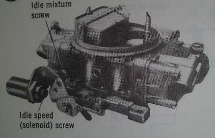

Good day, Caljim that wire seems to attach to the idle stop solenoid and another separate wire from idle stop solenoid back to the tcs on the gutter rail, as highlighted on schematic. Nice nova duece.
