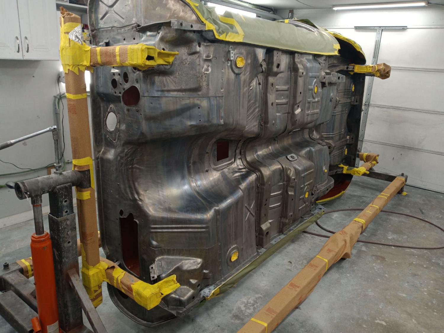

Looks good! Not sure of the body weight but it looks like you have ample sized slings. Keep in mind when tying a knot in a sling it can reduce the capacity of the sling by 50%. Wouldn't want to lose the load or hurt someone.
