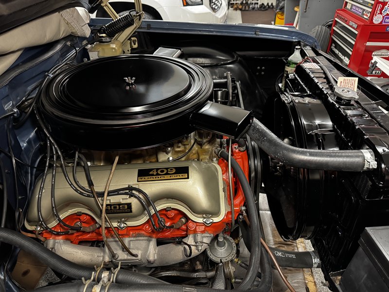

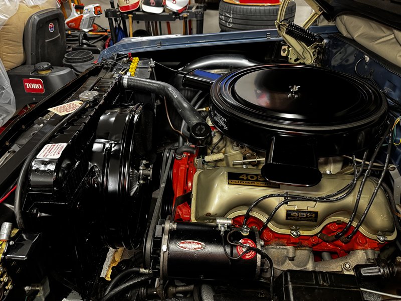

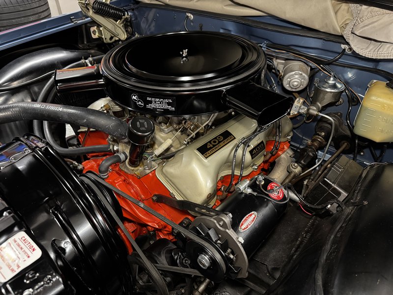

Seeing Tim's 67 L79 engine compartment pictures motivated me to get to work after I got home this evening.
I was able to get the under hood engine compartment pretty well buttoned up tonight after getting everything I needed rounded up this afternoon. I took off the header bar and had the painter get that while he did the radiator yesterday. He also did the fan shroud and air cleaner assembly. Last year I put a new fan clutch on the correct restored fan blade so that still looks good. The generator rebuilder took the generator apart and re-sprayed the case as it had a bunch of scratches in it since he rebuilt it a few years ago. Filled up the radiator with new anti-freeze and distilled water and installed some new decals while I was at it. Waiting for a few small things yet but getting pretty close now.
Final brake bleed (I've got fluid at all 4 corners) and front brake adjustment and I think I'm done..............for now.
