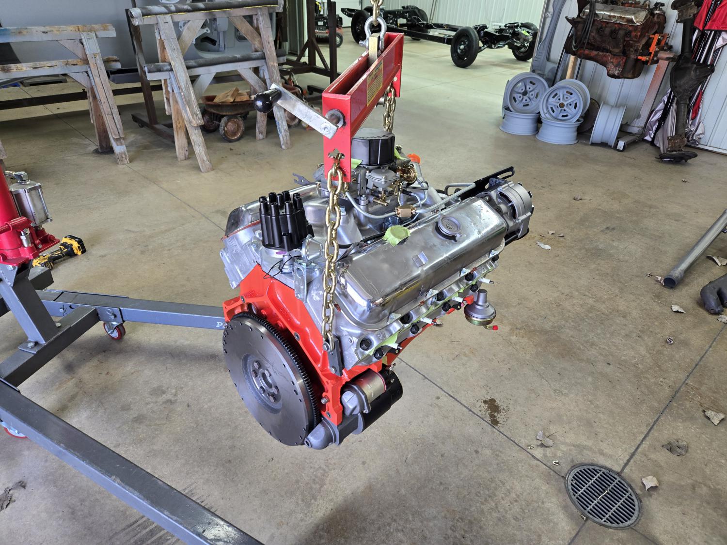

Default Off the Stand and Into the Chassis
Didnt feel like wasting any time. Got the engine off the run stand and into the chassis. Finsih up clutch, belhousing, transmission, and driveshaft. Then back to body work. Maybe I will setup a lemondae stand to pay for the exhaust.
