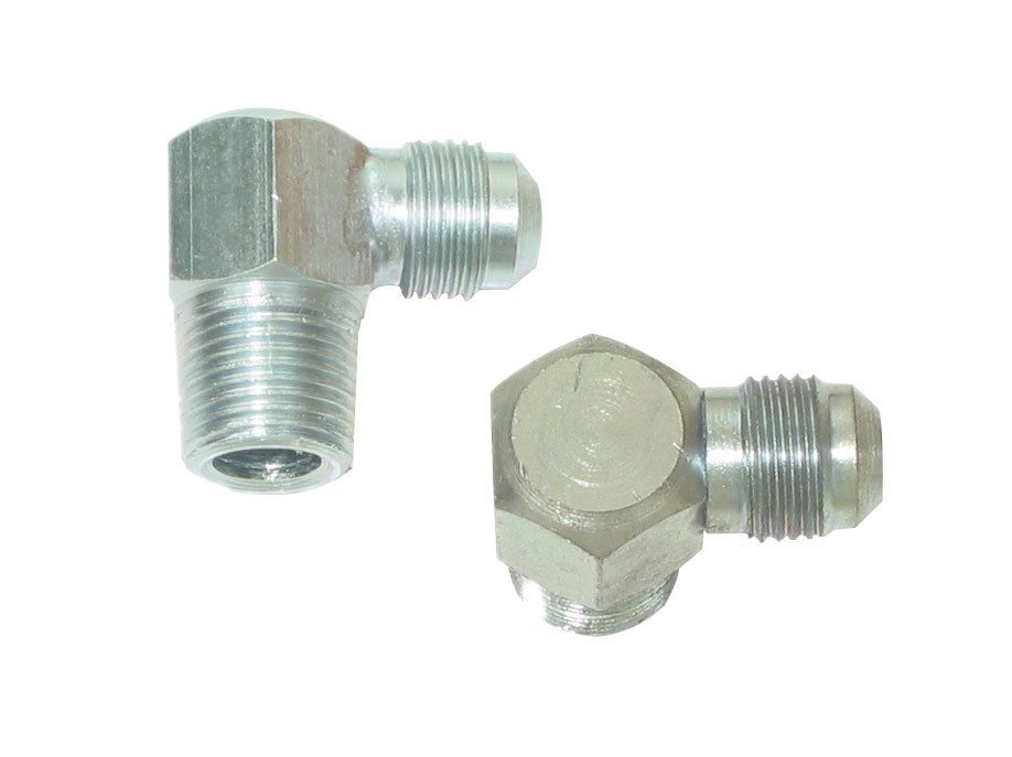

I found HBC has fittings, but does this have any extra vacuum ports or just one for the brake booster?

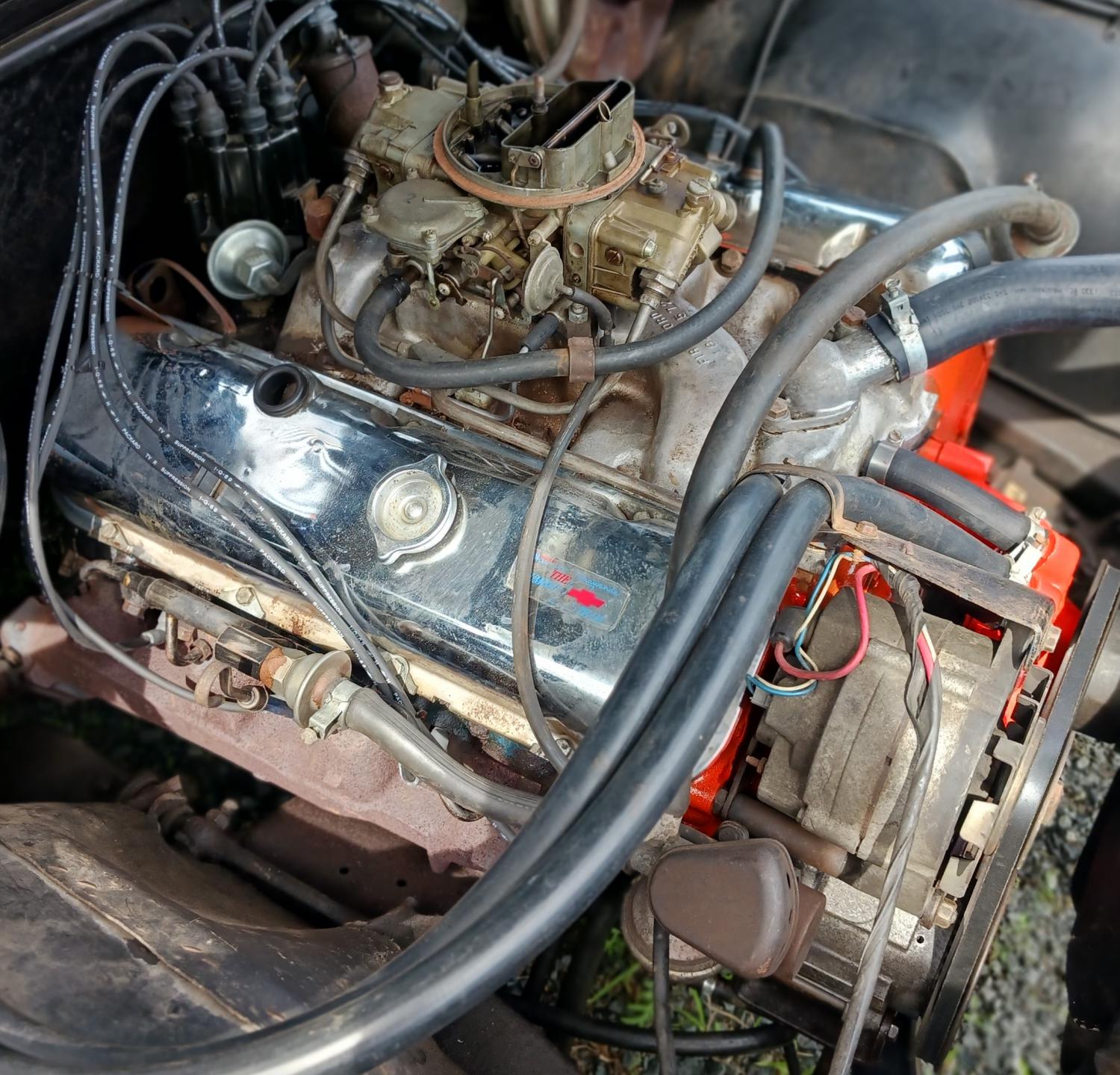

Looks short

----I just dug two out of my pile. The 1st has a small port directly out of the other side. The 2nd has a small port at about 2 oclock from the big port going to the booster. If this helps you can either one for the shipping....Bill S

Wouldn't the automatic cars have a fitting with 2 connections...one that goes to the modulator and one for the booster??

His car is a 4spd like ours. 1 fitting

Just providing an additional photo to backup Dave’s response. Single port for 4 speed cars.
Let us know if you need any other details.

OK now that thats figured out I need the tube and bracket if anyone has a spare
