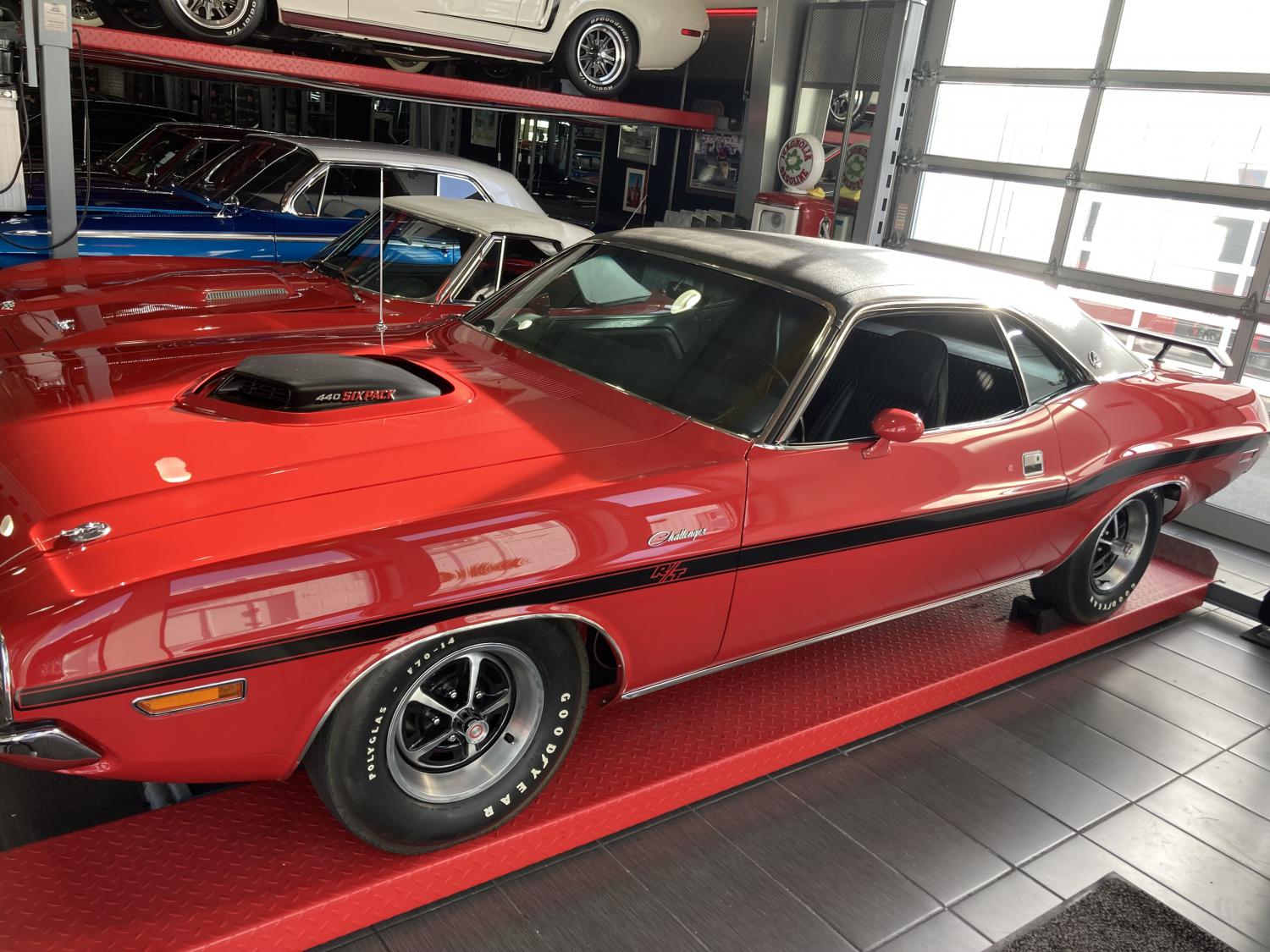

Default 71 Challenger 440-6 shaker stuff
I need everything from the intake to the hood.

Nice mix of cars, challenger,corvette,impala,mustang.
