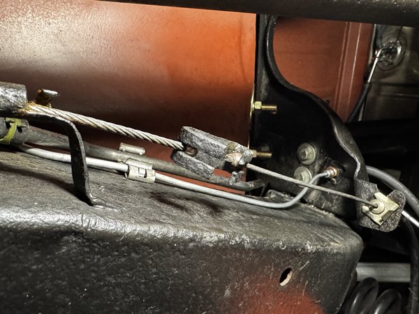

Spent some time last night in the garage and was able to get the old front to rear brake line out. Went to install the new line and saw the front end flare was boogered up pretty good so that ended that project for the night. Supplier sending a new one out today.

Got the new front to rear brake line installed, it intermingles with the fuel line and uses the same bracketry so it took some patience and creativity to make that all work without cutting anything, having the body on the frame, and doing this on my back with the car on jack stands.......but it's done and it fits. I also removed the front crossmember line and installed the master cylinder to frame line.
