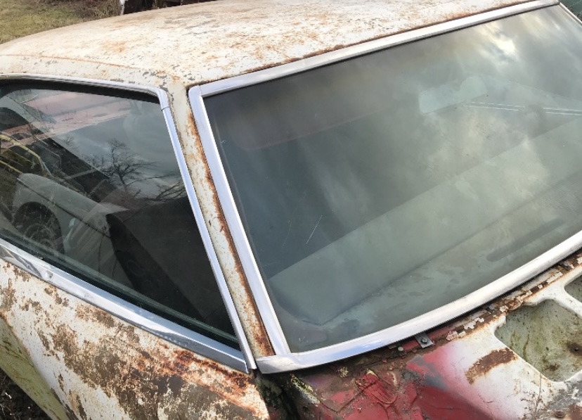

Tinted glass and 725 interior

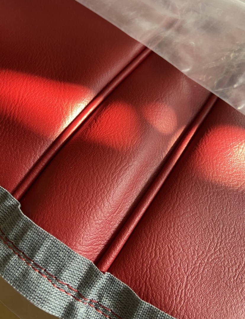

New covers and door panels have arrived. Original dash pad cleaned up and is perfect.

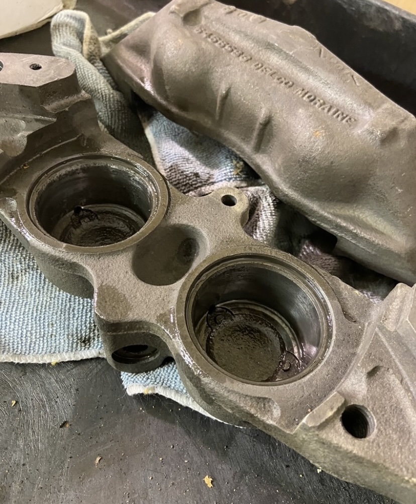

Lonestar Caliper sleeved the original units for me.

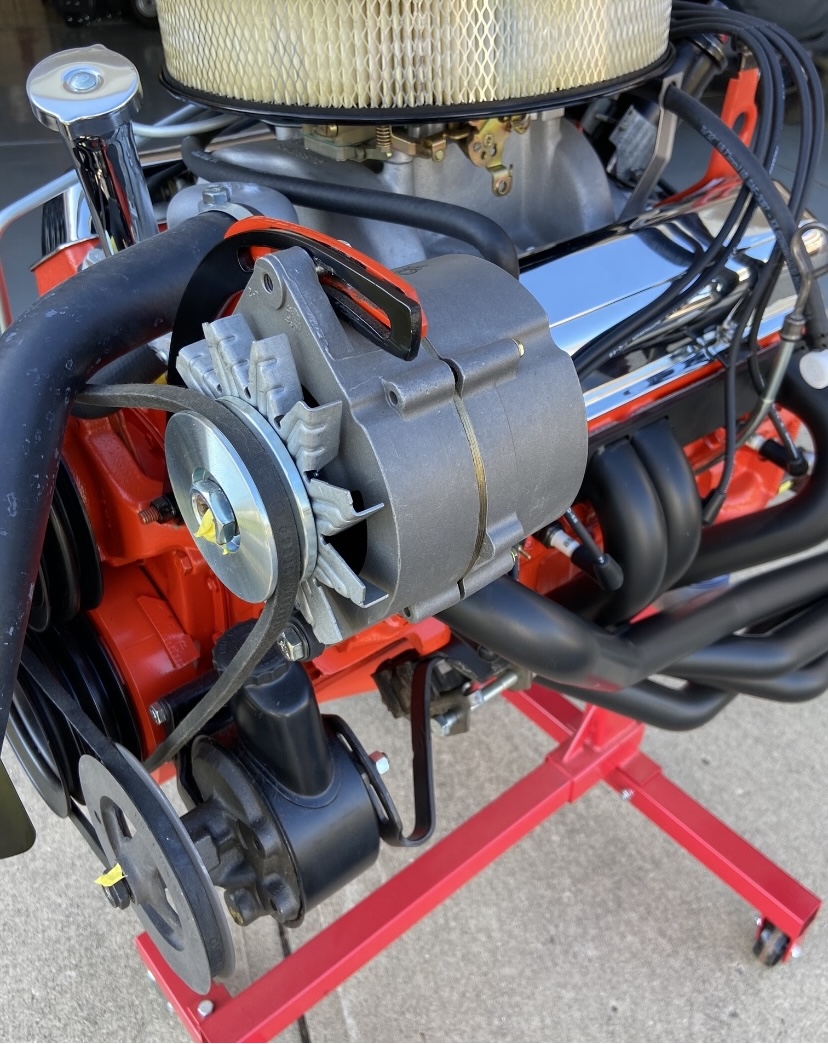

814 alternator. Special thanks to Paul L (HuggerSS) for locating the correct deep groove ps pulley. (Yes, wrong cap on the pump. I’ll fix that)
Also very elusive fast ratio 391 Pittman arm.
That motor is gonna love the 11.3 compression and the 4:88 rear! Hope you have enough vacuum for the power brakes.
olredalert (12-30-2024)
  #25
Old 12-30-2024, 01:03 AM
SMS's Avatar
SMS SMS is offline
Join Date: Jan 2018
Location: Indiana
Posts: 575
Thanks: 630
Thanked 1,808 Times in 335 Posts
Should have. I had Erson do a special grind on the lobe separation and overlap designed to enhance idle vacuum. Now that you mentioned it, I forgot to check the vacuum when I had it running so I’ll have to do that upon reassembly.

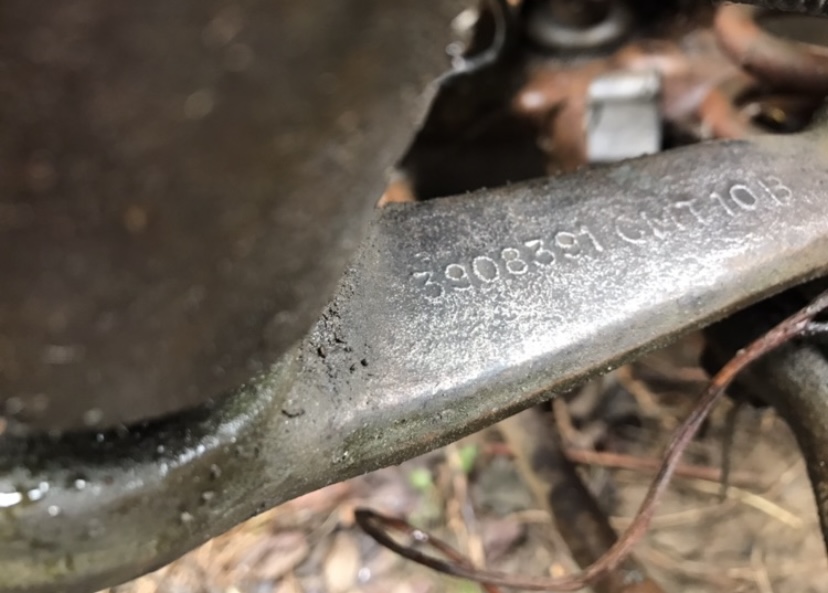

Rich P coming thru on specific bolt markings when I’m in a jamb.

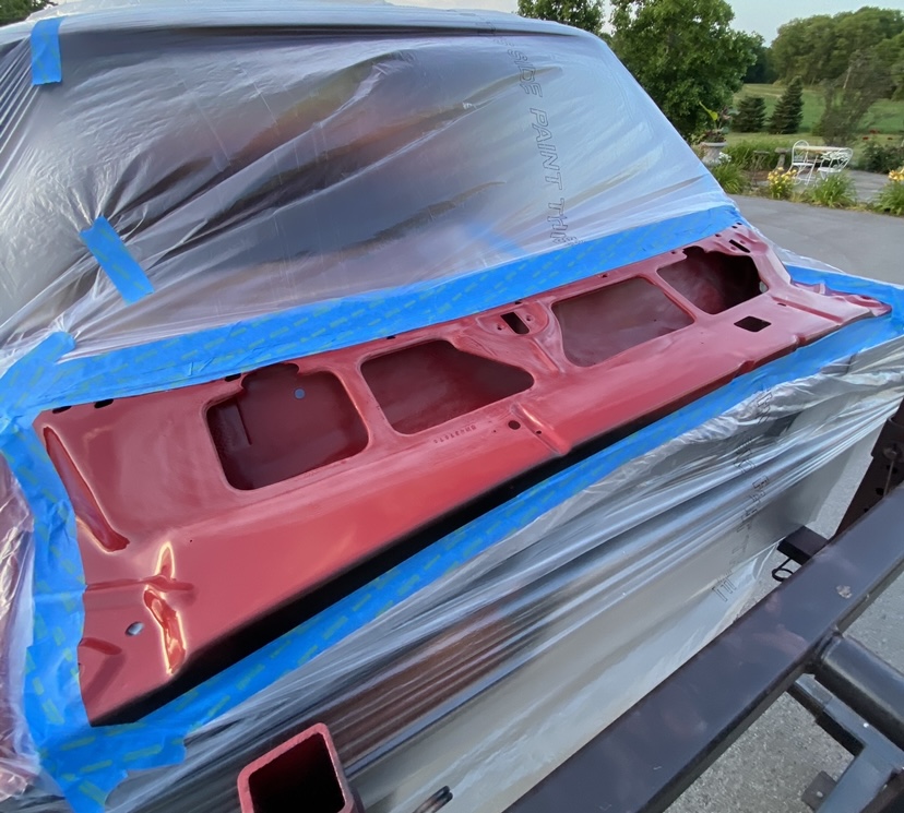

Red overspray and red oxide primer created in the interior.
