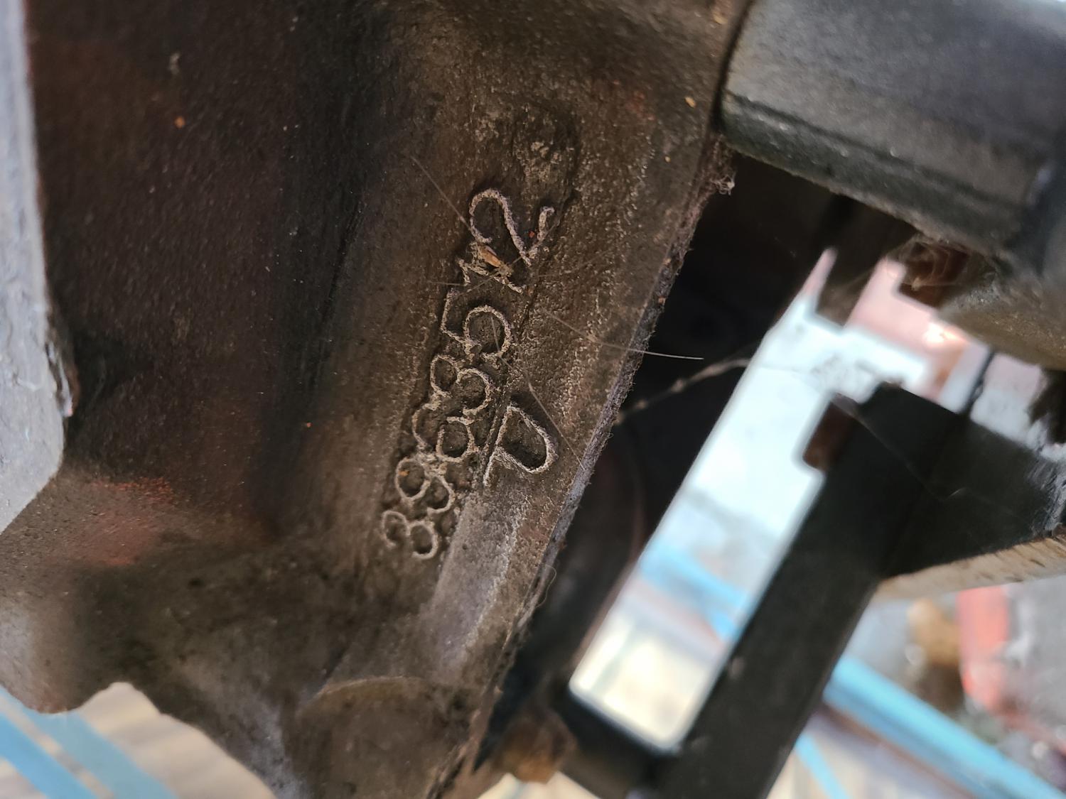

There are two possible locations for the casting date. Early 512s have the casting date on the passenger side of the block, by the freeze plug until approx March or April. After that it was moved to the bellhousing flange.
