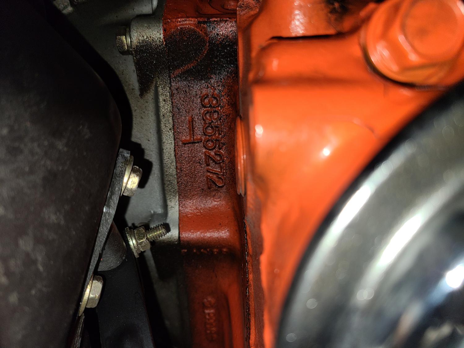

I know without documentation it can be argued back and forth all day. I was sure hopeful the build sheet was in the car but it at least wasn't under or behind the rear seat as I yanked that out to look for it. I didn't go any further looking though.
From all of my research (which isn't much in the grand scheme of you guys) everything you've said is right in line with everything I've read about too. I was fully expecting "JI" on the block and at first glance I thought it was JI but after cleaning the area some more and playing with different angles of lighting, it is definitely "T1106JM 19W353779". I will see if I can get a picture of it to turn out maybe tonight. I do have a picture that I took but I've doctored the picture so much to make the numbers standout that it really doesn't show an accurate depiction of what the stampings actually look like in person.
The Turbo 350 had me scratching my head too for the same thoughts as you, why would someone "downgrade" from a Turbo 400. You know, you bring up an interesting thought. I have been fixated on the big block because everything (minus the transmission and the questionable A/C) adds up to a factory big block car in terms of the big fuel line, dual exhaust mounts in the rear subframe, 5 leaf leaf springs, 12 bolt, etc. I didn't think about it going the other way of possibly being a small block A/C car that someone stuffed a big block into. That might actually be what is going on here. I say that because, man there is absolutely no indications of the sheet metal on the dash or the firewall being "massaged" and or messed with in regards to someone adding factory air components to a car that didn't have A/C to begin with. I would think if the body didn't originally have A/C there would be some signs of modifying something even as minute as possibly elongating screw holes or an opening somewhere but there is nothing that remotely seems tampered with or and/or cut.
I would love for someone who "knows" these cars to look it over because just the same, without documentation, it's still 50/50.
Here are some additional things to consider: A small block car could have a 12 bolt rear, dual exhaust and multi-leaf rear springs. As for the fuel line...the 350/300hp small block used a dual fuel line setup, one being the return. Not sure if the lower hp versions had this, they may have been single lines. Regardless...the 3/8" fuel line could have been added easily during the resto.
Did you state the car is badged as an SS..?? Another item to look at is the transmission cross member...pretty sure the TH400 version is unique. I'll bet it has a TH350 crossmember...
Based on your assessment that the car has not been modified to accept the a/c system...it is really telling me this was a converted car. Does the engine block have the large plug by the oil filter?? This was unique to the high horse big blocks...you may have a 4 bolt block with low horse parts bolted on....or whoever stamped the motor didn't know what they were doing.
Why not post some photos of the car and re-take a good image of the deck stamp...the gang here can help sort this out for you. There may be an SYC member near you who could take a look.
