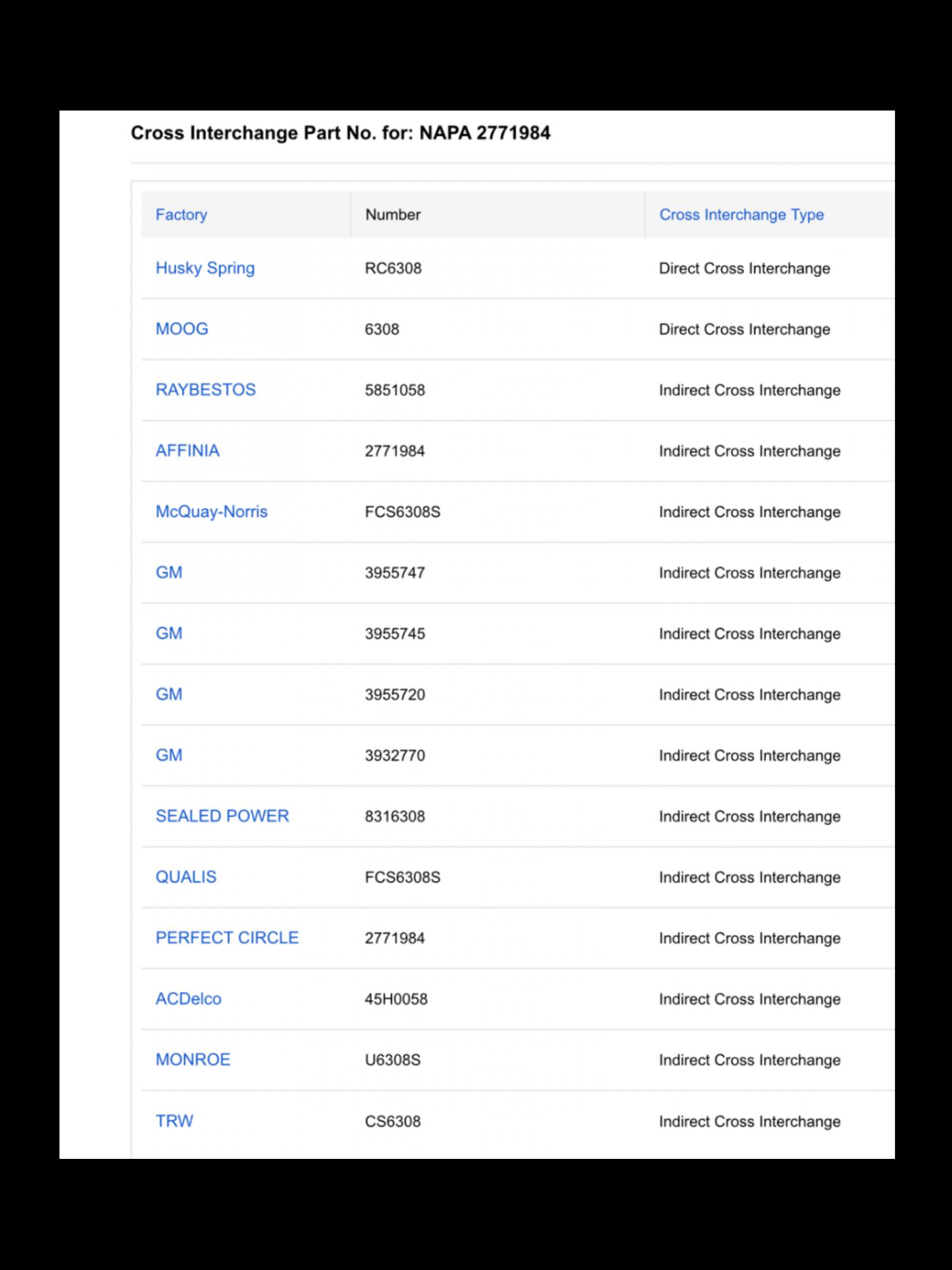

I saw the below Cross-Interchange Chart online, anyone please speak up if you know whether info correct or not also if any experience using products listed.
Chart is a Cross Reference for the Napa 2771984 which it and the Husky RC6308 are both listed as DIRECT Cross Interchange w/ the Moog 6308, others on the list noted as Indirect.

CS6308 is noted TRW at bottom of above Chart but as Indirect Cross Interchange?
Again, would Napa 2771984 or Husky RC6308 being Direct Interchange be better than others listed as Indirect or Products known lacking in some way?
Here’s a Moog/Napa Spec page below, how’s it compare w/ Factory Parts?
