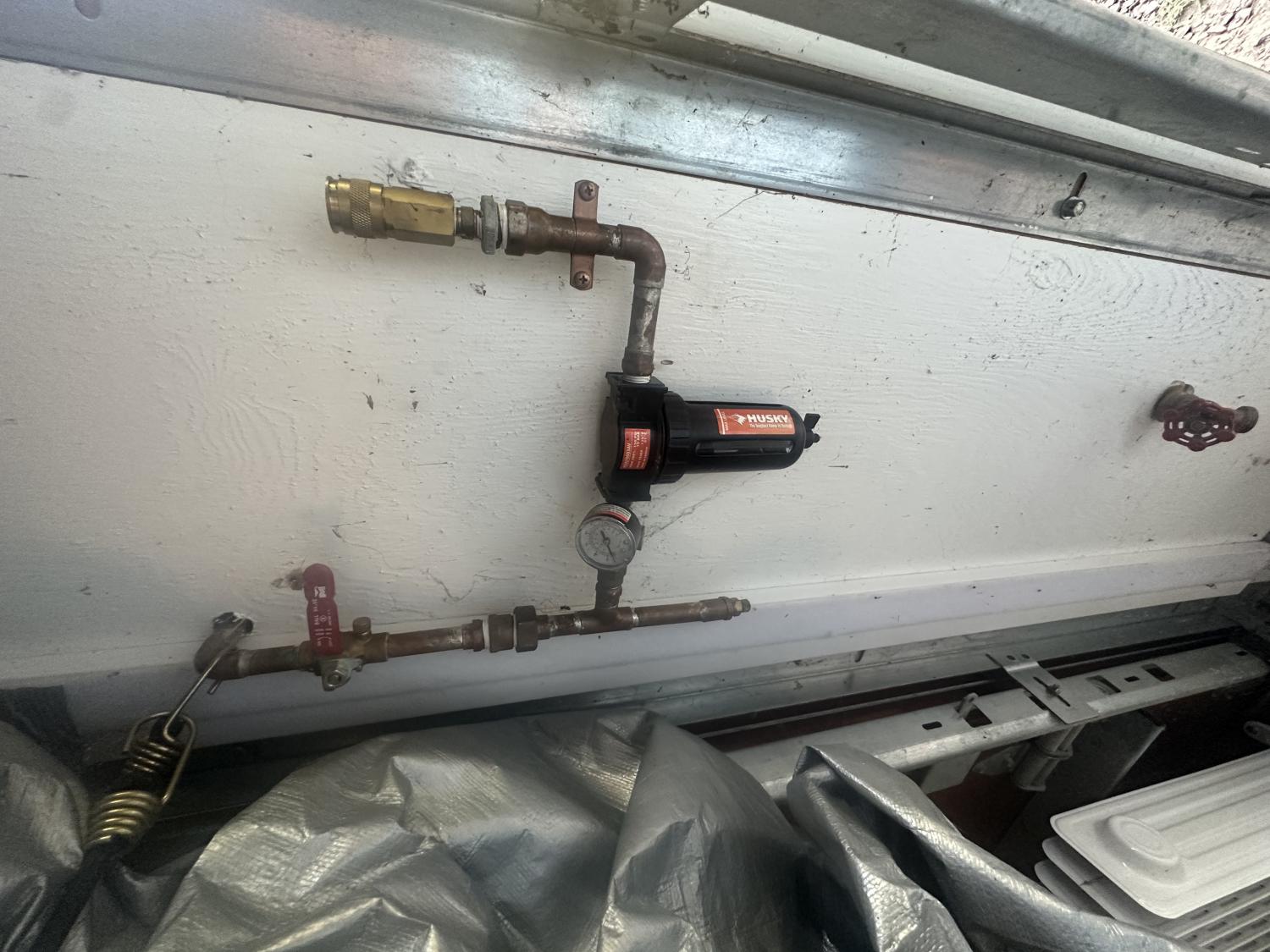

Hi everyone. Looking for advice on the best air piping to use for garage compressed air system. I would like to conceal in the walls and above the ceiling for the installation method. What is everyone using?
Thanks!
Bob
Attachments - The Supercar Registry FBE58E89-939E-44AC-B0CC-1F1F08B4DB8F.jpg ACAC639A-6DE4-4F45-9BAC-3993736AFEDE.jpg
