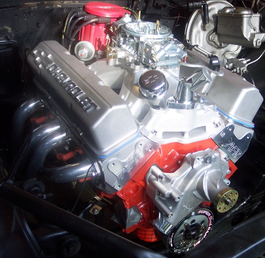

New project removal and rebuild of engine in orange with black stripe 69 RS/Z28. I have antifreeze entering cylinder #8.
The engine is ready to pull all everything is disconnected. It could be a head gasket, but two issues the engine had.... low oil pressure and somewhat of a vibration. I had the engine rebuilt by a local engine shop and it produced great HP 411 at 7100. The rub is I had normal oil pressure prior and no vibration( yes I had the flywheel & pressure plate balanced.
I was considering purchasing a "modern crate " and install. Also have the original engine rebuilt and stored.
Any suggestions? My one thinking has always been the 302 is really the only unique item to a Z28 which is the reason I have stayed with the 302.

It was rebuilt and reinstalled March 2013 and has 4.5 k miles on it. It had 492 angle heads installed and I changed back to correct dated 186s. The 186 had smaller 1.94 valves, but upgraded to 2.02. I suspect a head issue because the builder noted he ran into some issues at the time.
I considered stroking but again I wanted to feel that high reving low torque 302. Based on the dyno sheets it produced 373 lb/ft of torque. I will likely stay with the orig engine configuration. We will see.....
