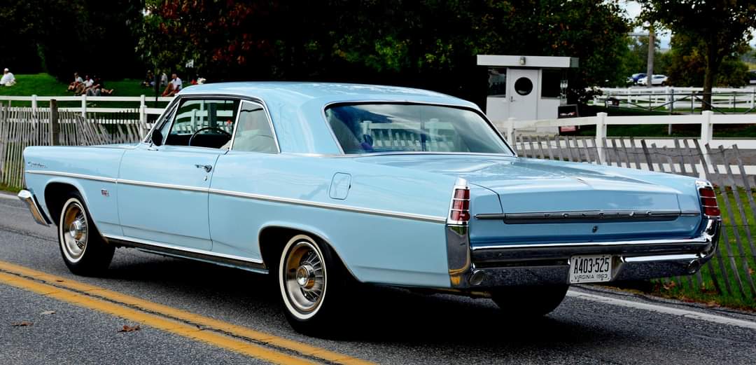

Don't know if this helps, this is my 63 Catalina, 8:50x14 B.F. Goodrich with 1" whitewall. Tires came from Coker. Standard size for 63 is 8:00x143 with 8:50 optional. Picture didnt load, will try again

My 63 with 8:50x14 with 1" whitewalls
