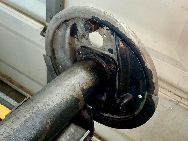

Originally Posted by big gear head View Post
You wouldn't believe how many people laugh at me when I tell them to seal the splines. Put the sealant in the yoke, NOT on the pinion shaft.
See who's laughing when the yoke slings gear lube onto their floor pan and mufflers...
