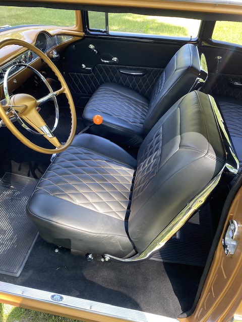

----The interior is gorgeous. Looks like it's totally done in leather. Am I right?....Bill S
  #152
Old 12-02-2023, 06:02 PM
jasonL78 jasonL78 is offline
Join Date: Mar 2006
Location: New york
Posts: 1,423
Thanks: 4
Thanked 431 Times in 85 Posts
Yes sir all leather!
