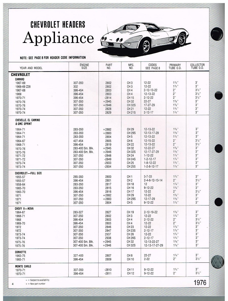

Thank you jbtech……..very much appreciated.
Pete, I agree with you, if I didn’t know any better, I really thought that they were for first generation Camaro with the pictures you posted…..I do think they’d fit…..and they’re 2” primaries…..like you mentioned.

Hi everyone, Chevy admirer from afar. IÂ’m a Buick guy. Last year I bought a 73 corvette that came with a set of NOS new in box Blackjack headers. I have since sold the car but still have these headers. This thread is the most informative on the internet in my searching so thought I would try and revive it.
A few things I notice compared to other pics. A lot of NOS headers have made in Mexico on the AK5000 tag. These just have “Mr. Gasket California”. I don’t see a part number on the headers that match the above catalog, just number 95822 on the box. The alumacoat is thick and could be hiding it. Did Mr. Gasket acquire blackjack later on? Any idea what these headers are for? They are 1 3/4” primaries and 3” collectors.

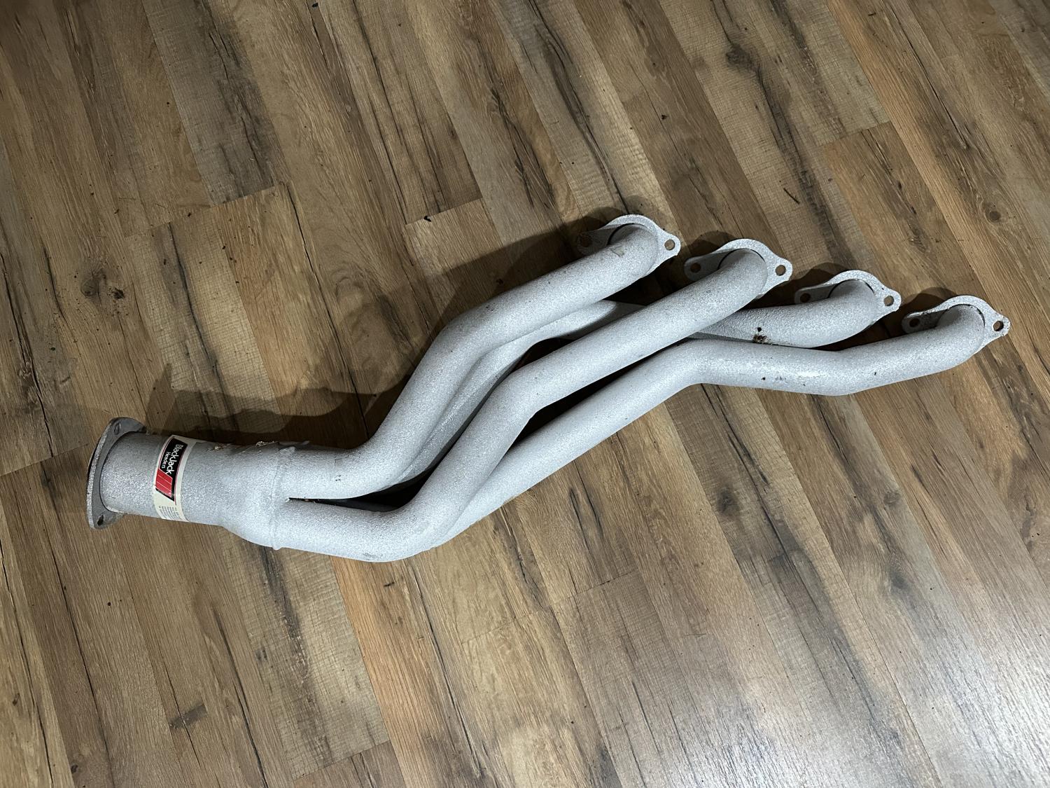

He missed a set at Jefferson last weekend! I bought this pair of 2" primary, 3-1/2" collector, square flange Appliance B-body headers there.

No B-bodies hidden here. I called Chad as soon as I figured out what they fit, but he's a bigger tightwad than I am, so we'll see... They'd look good on one of his L72 Biscaynes.
I just saw square flanges and a cheap price, and took a gamble on them.

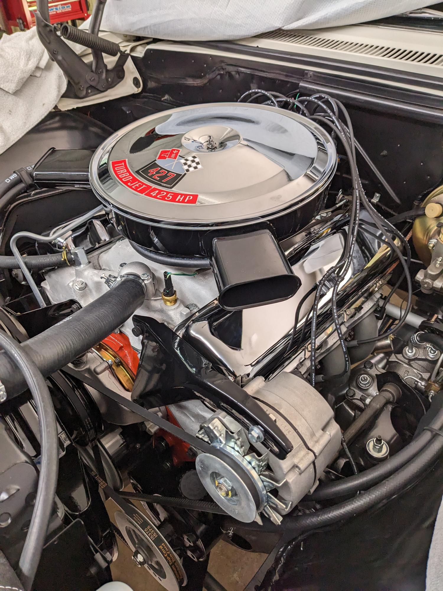

Here's the set I got from Kurt on my 66 Biscayne.
