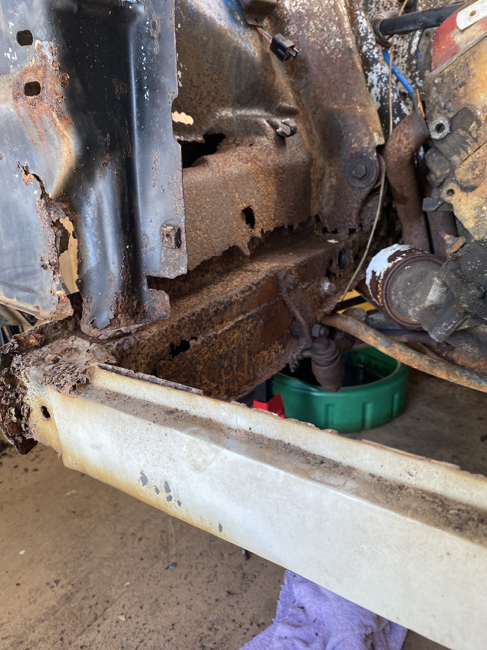

Getting everything home that day I began to survey what I purchased. And what I purchased wasn’t great. On the way home the right side shock tower separated from the frame rail due to the amount of rot, nothing on the car was straight or pretty, and it was very clear that the mini-tub job done for the N50’s was done in a backyard and of questionable quality 50 years ago. And now was downright scary. But I still fell in love with the car, though I’d call it more of a love to hate it type or relationship.

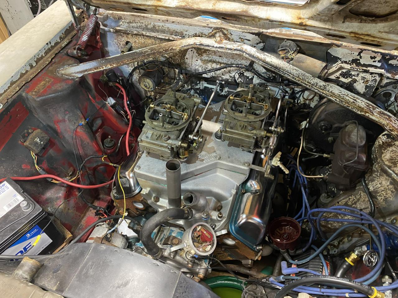

Then it got accepted into the Barn Find area at MCACN 2023, so a new plan was hatched. The block was as the machine shop and I was already building a 13:1 390 using BBC rods, Pontiac 455 pistons, the largest Mechanical flat tappet cam that Lunati makes, and ported 291C heads. Why not have this thing running and driving like a vintage pro-stocker while it looks like it currently does?
Unfortunately I had started stripping the interior of the car to start the bodywork. So over the course of months I reassembled most of what matters, and tackled the largest metal job that needed to be done… that right frame rail.
It was junk. So my dad and I, without fear or any idea of how to do it, chopped the right front frame rail out of the perfectly good 290 parts car and began mocking it up in the SC. There were some changes from 1968-1969, but nothing that couldn’t be overcome. Soon enough there’s a complete frame in the front.
Now back to the engine. Assembled in my garage and after all clearances are checked, it was installed not painted and ugly, along with the original T10, though there’s no vin on it the dates line up perfectly to the build date of the car.

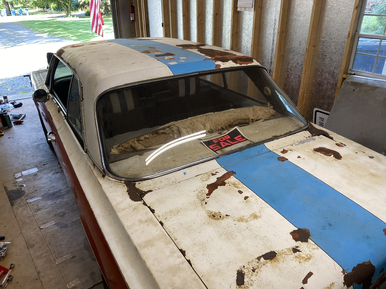

My trail went cold there, then, months later I decided to take the rear window regulators out to free them up. Inside the drivers side quarter window slot I found a For Sale sign with a phone number. Googling the number I eventually tracked down a disconnected phone number to Astoria Queens. Bingo.

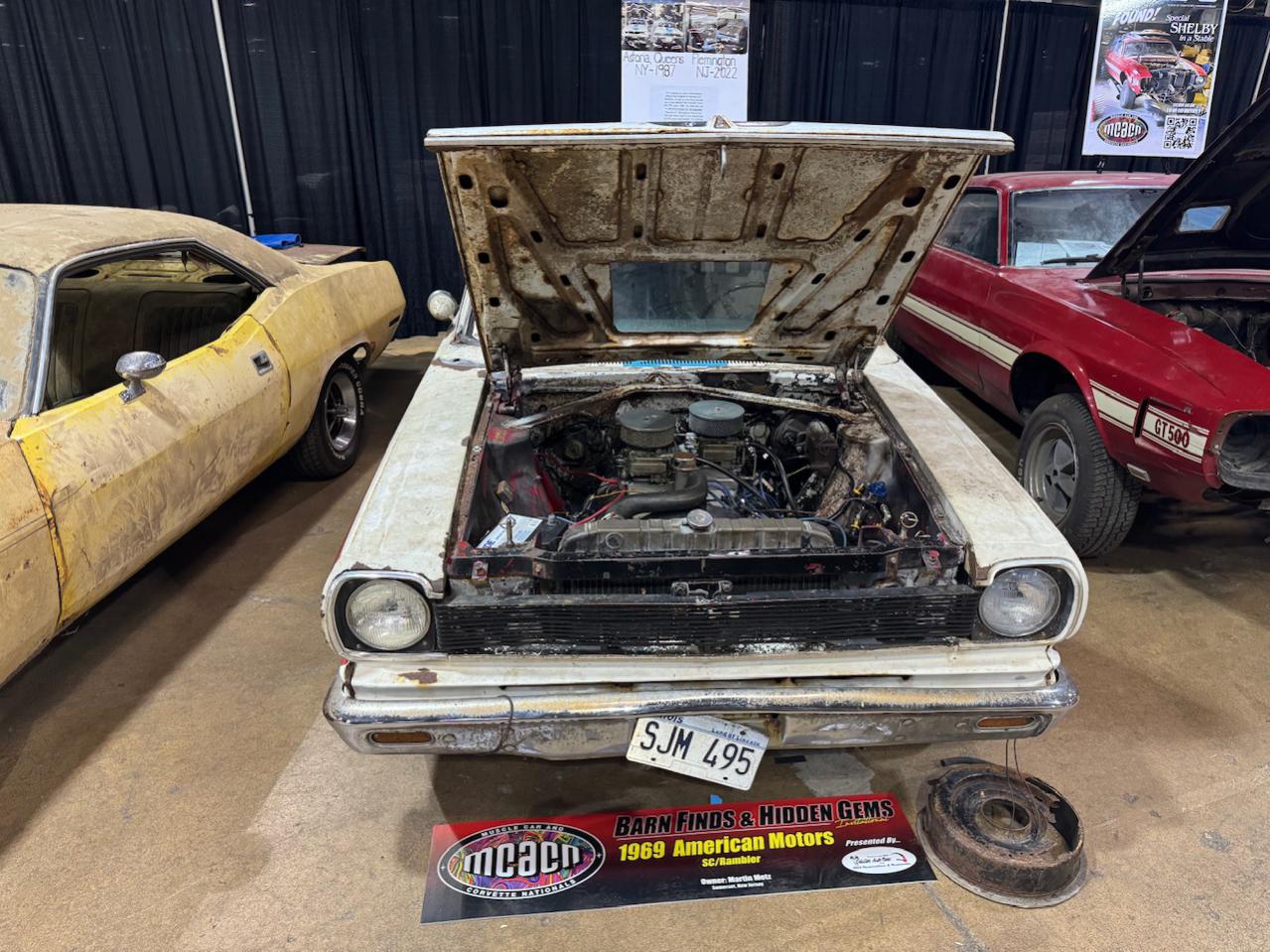

Photos from MCACN 2023 and a preview of a Hemmings photoshoot that was done a month or so later. The photographer is still working on the article. Very nice gentleman named John.
