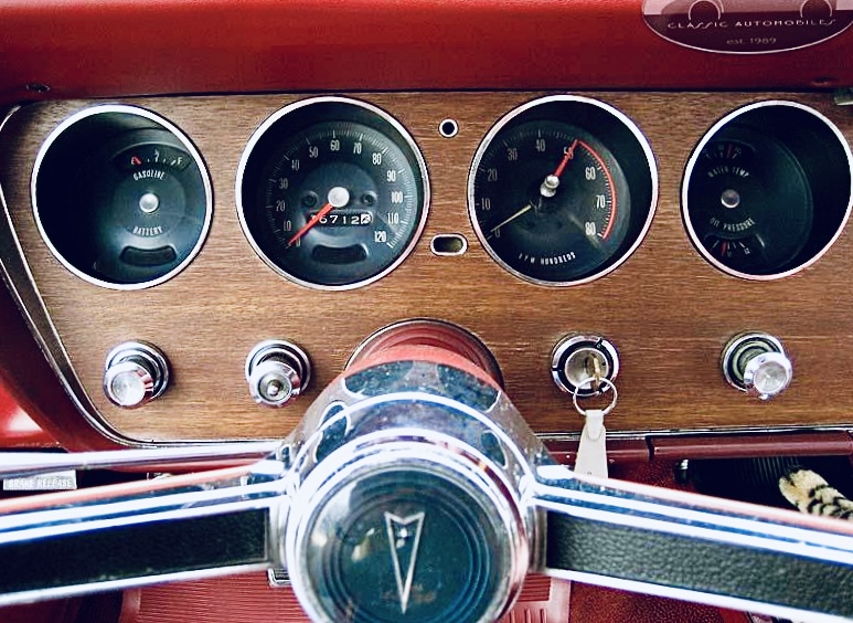

This looks familiar. Seams to have acquired a rally dash.

acquired during the restoration no doubt. New firewall pad and footwell plate too along with many other items. I guess you either want a time capsule car or a restoration, which this is. Awesome car though.

That ‘65 has popped up in different hands several times over the years.
The car was built with standard gauges, but someone has installed a modified tachometer where a dummy plate or Rally clock would be.
That tach looks to be a ‘66 version with the needles wrong and/or missing.
1) ‘65 dash in question.
2) ‘66 Rally dash OEM.
3) ‘65 Rally dash OEM.
For that price you would think ….. 🤔

That's an aftermarket tach that repro parts houses sell.
https://www.ebay.com/itm/271172365553

Aftermarket radio, too?
The radio knobs in my car match the headlight/wiper knobs, like the bottom picture.
