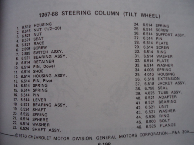

Default Tilt steering column 68 or earlier.
Looking for a schematic for a 68 or earlier tilt steering column. Application is for a 68 Camaro but any GM will do other than telescoping or Corvette. Lots of info for 69 and up locking column but can’t find any for 68 and earlier.
Parts illustration books should have a page but mine only covers 69 +.

Old 01-10-2024, 08:47 PM
Posts: 21,013
Thanked 3,721 Times in 1,497 Posts
This from my original 1970 Chevrolet Parts & Accessories Counter book that is 10" thick.
