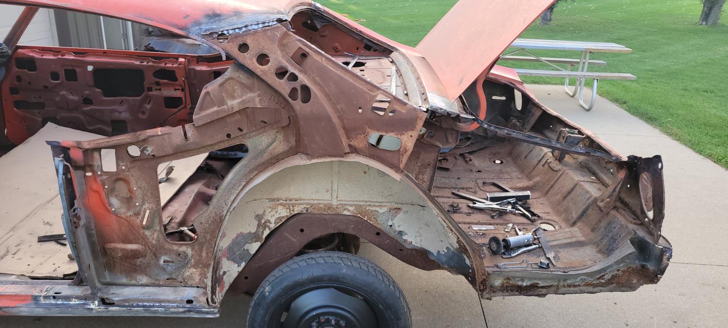

  #66
Old 01-01-2024, 12:35 AM
OneStopRestoration OneStopRestoration is offline
Location: Washington, Illinois
Posts: 296
Thanks: 86
Thanked 1,591 Times in 225 Posts
Default Package Tray and Backseat
It appears the drivers quarter was hit directly over the wheel. Hit looks like it happend high. The shop that fixed the car just pulled the wrinkled outer wheel house out and dropped a new quarter on. What never seemed to car about was the inner wheel house actually buckled where it meets the trunk floor and shifted into the trunk space. Not hard to fix. I had to remove the package tray outer trunk panel from the quarter/roof section and then after a some thought had to install a bracing setup to allow me to use a hydraulic ram to push back on the wheel house to roof structure. It actually was really easy to get it to move back out. Did a few dimensional checks to the passenger side and it all went right back into place.
I had to remove both the upper package tray wing, and lower wing that mountes to the outer wheelhouse. Once straitented I put them back in place along with a new donar seat back panel.

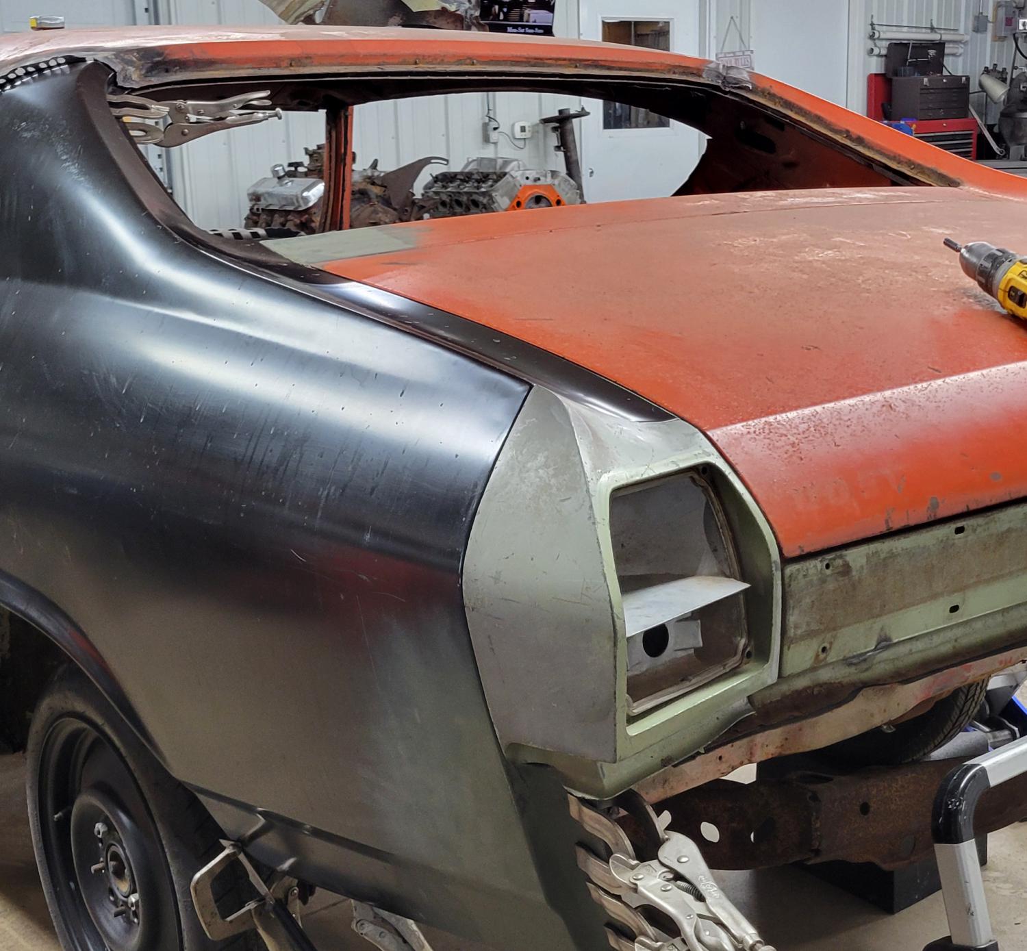

  #70
Old 01-22-2024, 12:54 AM
Posts: 296
Thanks: 86
Default Driver quarter assembled for the final time
Drivers quarter is now on. Happy with the door gap and face fitment. If you handnt already noticed i replaced the entire rear panel as well because of the trunk gutter being all mangled and the fact the the drivers side was wrinkled up and just couldnt be brought back. Got nice fitment beteween the deck lid, quarter, and quarter extension on to the passenger side now.
