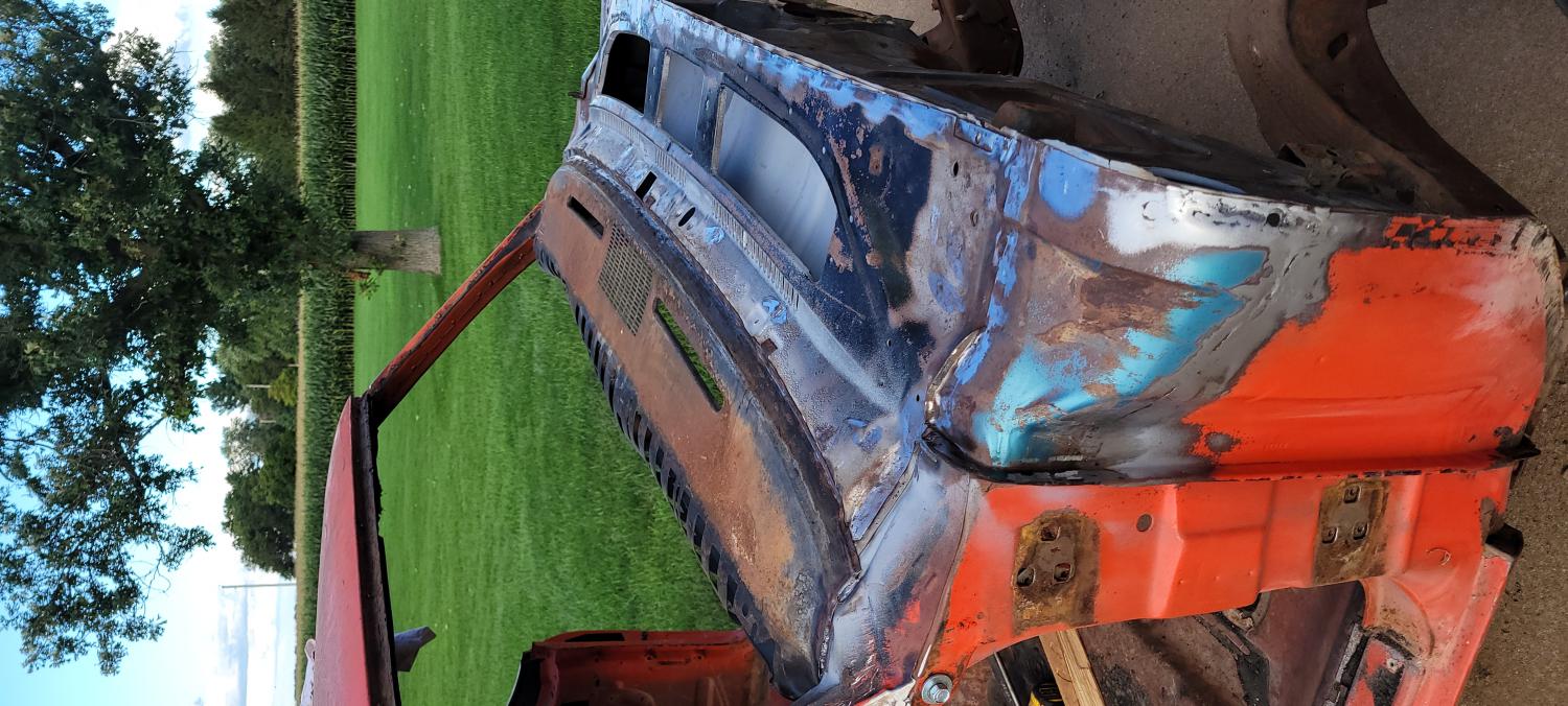

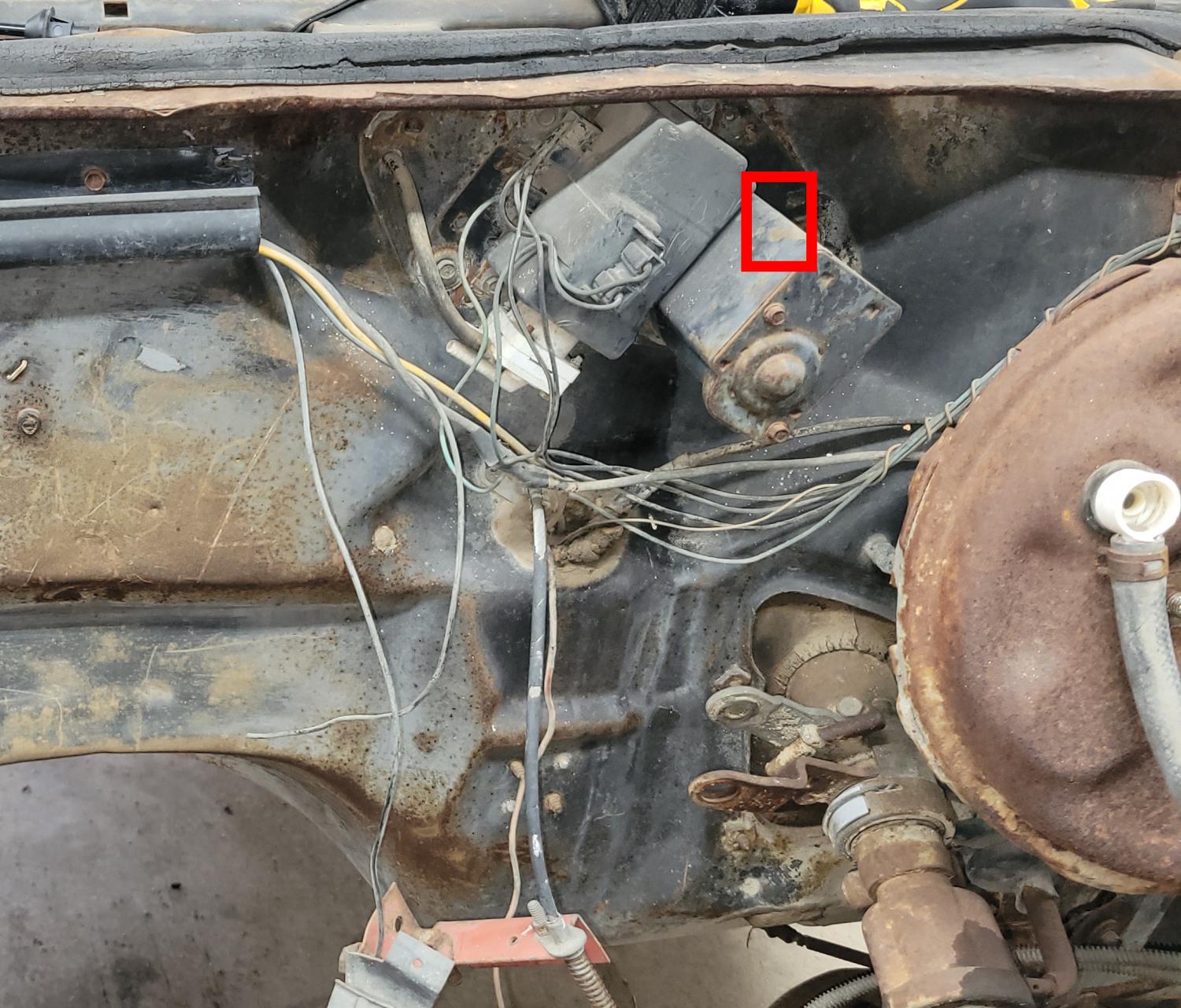

So I had known that the 300 deluxe cars got some stripped down items that can be normally found a regular SS or Malibu. One that had to do some digging to understand was the trim piece at the base of the window. This car did have some very high front end damage in its life, and I noticed it had the hideaway headline trim piece, but had the square non hideaway headline wiper motor. After i pulled off the trim piece it was obvious had the thinner non hideaway piece as can be seen by the line where the paint is faded, and the fact that all the holes where in the cowl for the smaller piece. I also found what I think is a date code on the motor. Im taking a guess here that it means 38th week of 1968 so thinking its original.
First picture is with the trim piece above, the line clearly shows the thinner piece left a fade mark. Second picture shows one I found in my dads stock from a heavy chevy. More to come on this later

3868 In Yellow Ink

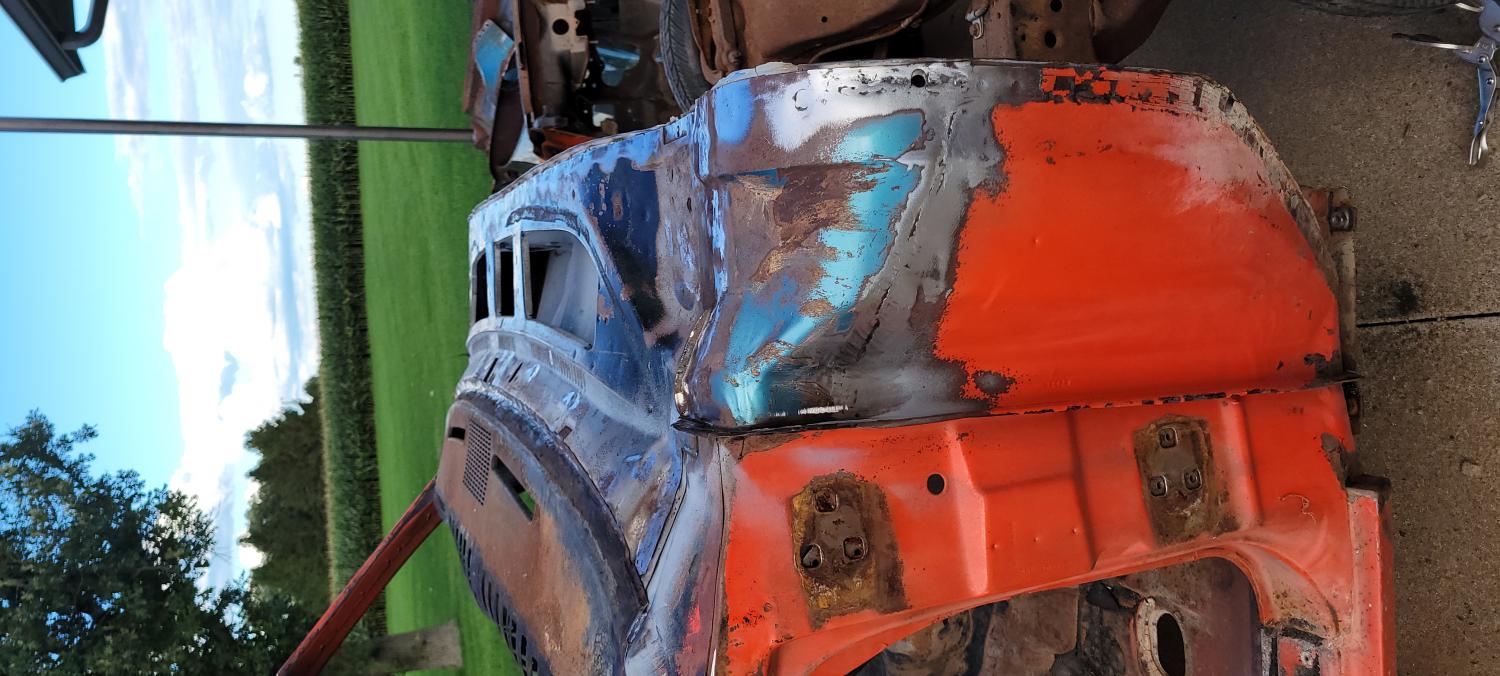

So if anyone has a sharp eye you should have seen the very upper part of the cowl on both sides where the front fenders mount had received damage. My best guess is the car was hit at grille level or higher, and the fenders and hood pushed back wrinkling the top of the cowl on each side where the fenders mount. If you study the pictures you can see the rusty areas where the cowl popped the paint from the wrinkling of the metal.

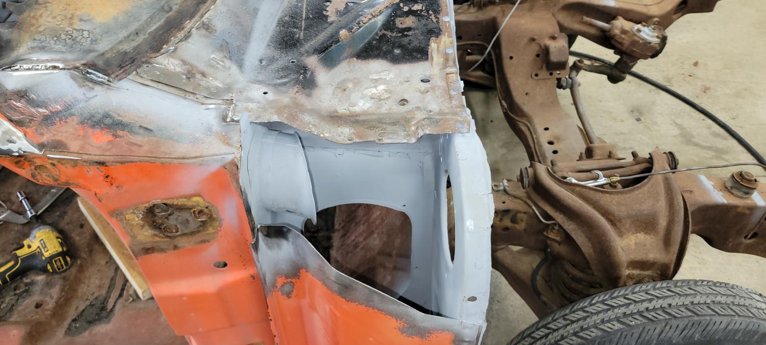

Default Donor Cowl
I was able to source a donor cowl from another 2dr 69. I was happy to find it but not happy that once I removed the dash on the donor that it was pretty rotted underneath. This meant 10-12hrs of fixing the donor cowl before I could even tear into my car

Default Damage Before on the Side Wrappers
Note the rusted areas from the paint being crinkled so bad
