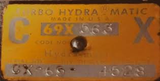

The removable tag on the tranny would the part of tranny which would indicate correct for the car.I would imagine that tag can easily be replicated . In other words buyer be aware?

Yes the Turbo-Hydramatic tags are riveted on the pass. side of the case...but, if it is an assembly line unit there will be a VIN stamp on the case in one of two locations. The stamping will indicate model year, assembly plant and last 6 of the VIN. Just like the deck stamp on the front of the engine...the application can be defined from that info.
Additionally, there was often a screen printed letter code on the case...for the 70 hi-perf it is CW and is typically pink.
-wilma

The assembly line Hydramatic Trans tags have decipherable info stamped into them as well.
Application,model year,date assembled,seq#.

I have made a decal to restore the trans ID tag. The stamps used to impress the #s are very very hard to find with the correct font.

Said decal.
