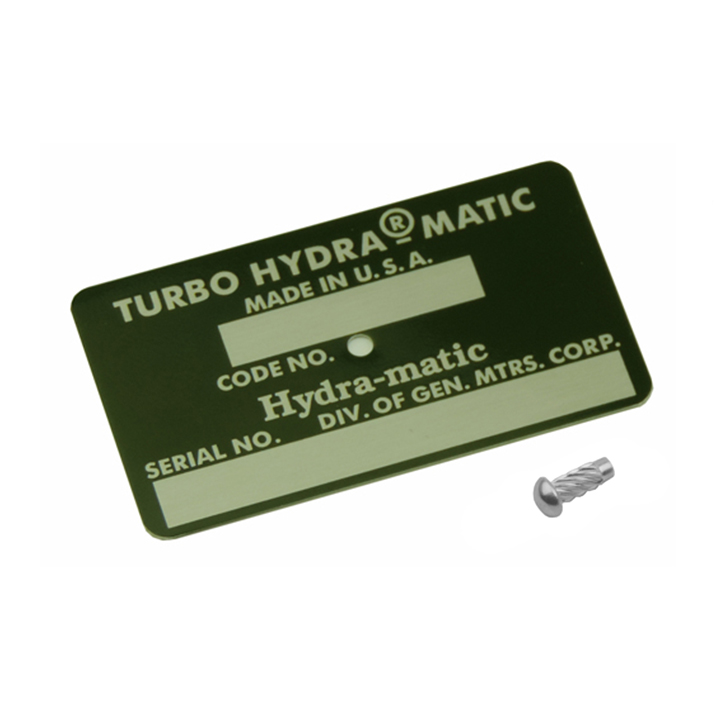

Looking for a transmission shop to restore/rebuilt my 1970 TH400 in N Calif. The prior shop that did the work thought it was good to spray paint the casing silver so it will need to be striped to the natural finish.
This is for a concours restoration.
Thank You

Consider using this. After removing the tag and striping the paint, spray on and rinse off, it can work miracles on raw aluminum. Do NOT use on polished aluminum though.
Metal items like the governor cover and bail Evaporust may work well. - Bill W

The tag on the passenger side of the unit will tell the story on the trans.
