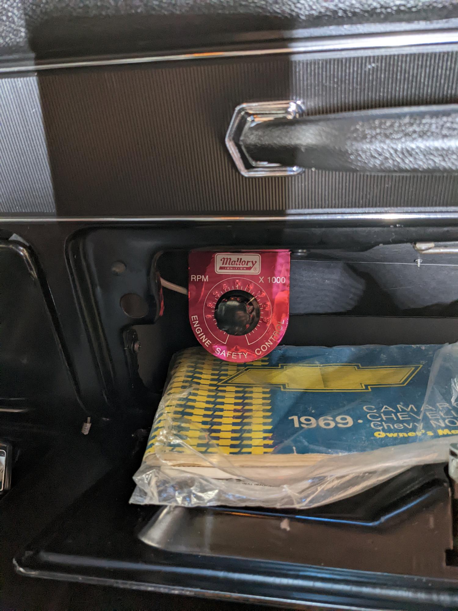

This is in my 1969 Z28 on works perfect.

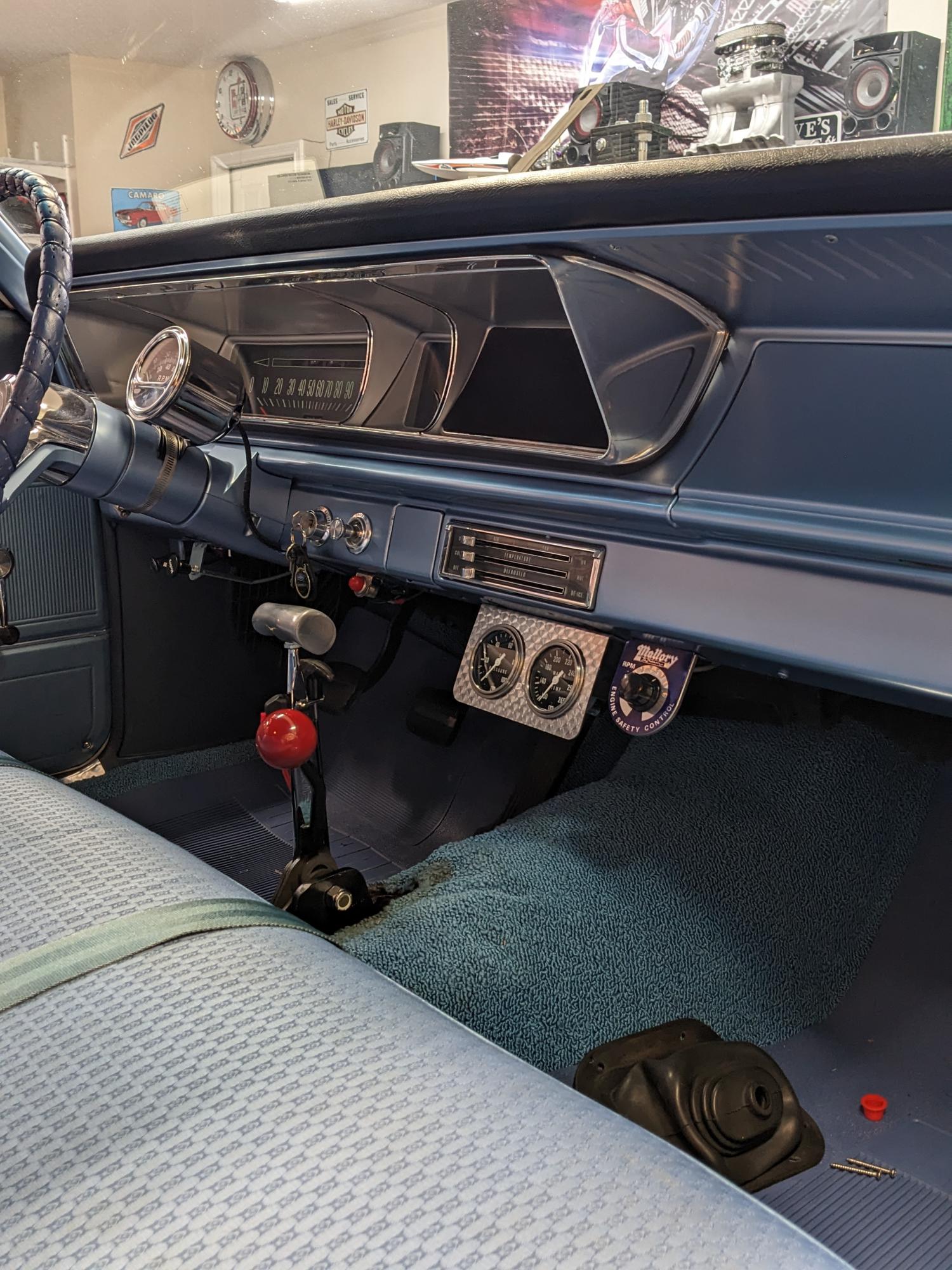

NOS going my 1966 Biscayne.

In the Biscayne and works perfect!

Thanks for the pics from OWTLAWPERFORMANCE. In the 'glove box' keeps the interior looking stock and out off view. We had a friend that had one in a 66 Nova under the dash. When we were out and about we use to "F" with him and adjust the dial back a few thousand. He never look looked at it when he got back in the car...and the fun started there. He was a good egg though. Yours looks right at home in the Biscayne next to the gauges, but the Camaro with the console gauges doesn't have the same space and I want mine seen. So, I'm looking at location ideas.
One more question, where is the box going to be installed? On the engine side of firewall or inside under the dash. The 28770 states close the coil.
Gary
Gary,
Both of mine are mounted under the glove box attached to the liner. The box weights nothing so no concerns supporting it. All wiring is under the dash except the one wire running to the coil.

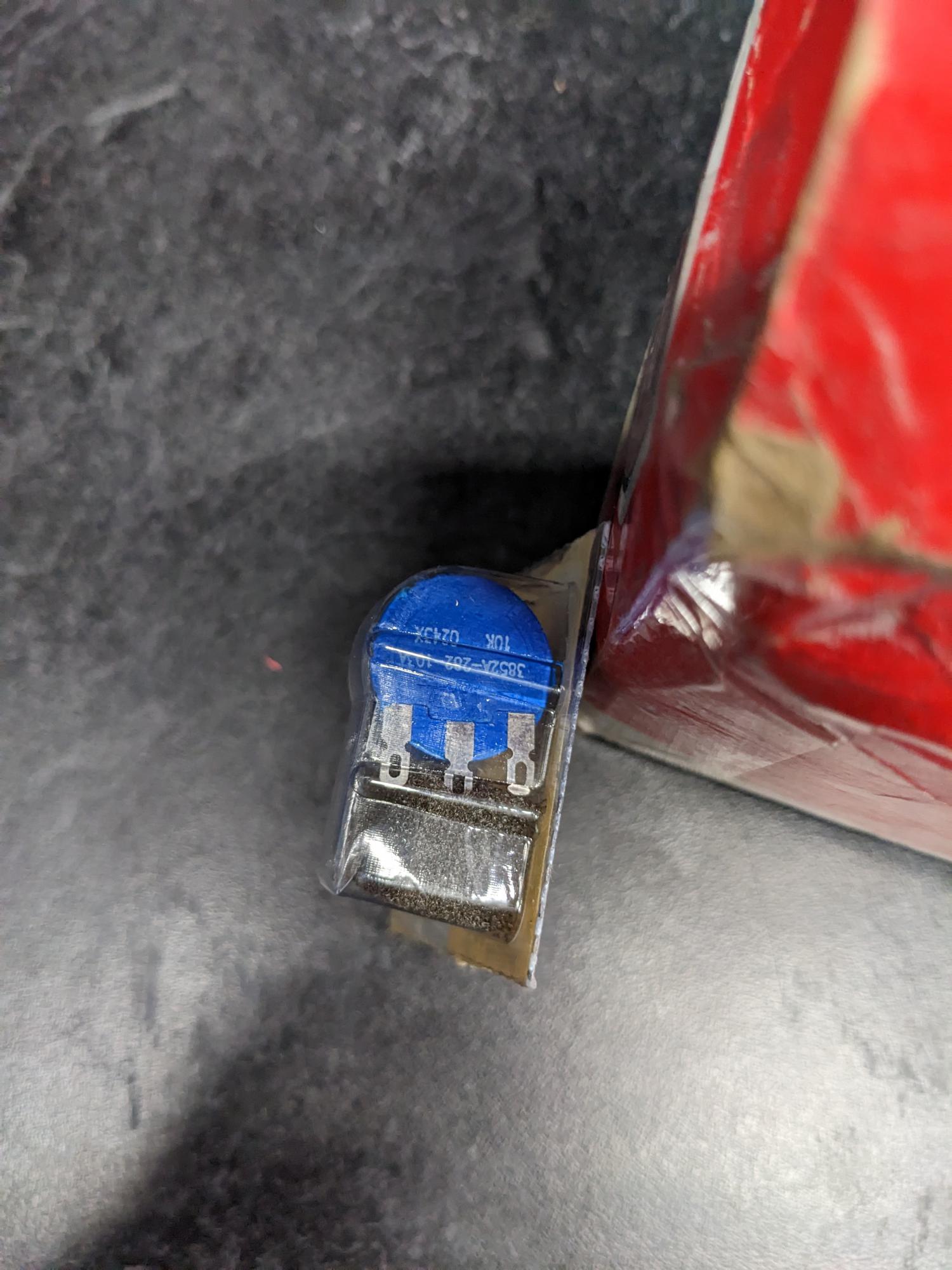

The unit got here today. Isn't there supposed to be two wire connections on the back of the dial? I only have one.
Gary,
I have three of these and all of them have three wires. The box has three wires from the dial and three wires out. Red positive, Black negative, Green tach.
I attached a new dial their plastic on the back now, but same as the same original part number when cross referenced. I hope this helps.
