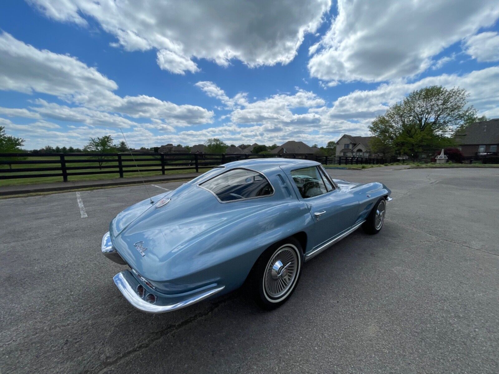

Nice car - amazing (to me) that the bidding is already in excess of $150k with the reserve not yet met.
Link to 1963 Corvette SWC eBay auction

I'd say the bidders are either shill, or uninformed. It has the remaining bracket for power steering which was not available on a solid lifter car. 250 or 300hp only.
Good looking car for sure!

Good eye, Tim. Cross drilled rotors and disc brakes on the front. Certainly, no pad or trim tag pictures also raises concern.

Not seeing fins on the back side of the balancer either.
Love the laid back aftermarket antenna

----How about the lack of the water pump to intake bypass, as well as a decent amount of front clip work. The rain gutter under the hood is missing the lip and the bond between the inner fender and outer fender is not well done.....Bill S
