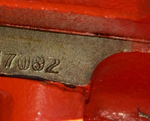

Here's an interesting one where they changed the 9 to a 6 on a 435 horse '67 Corvette.

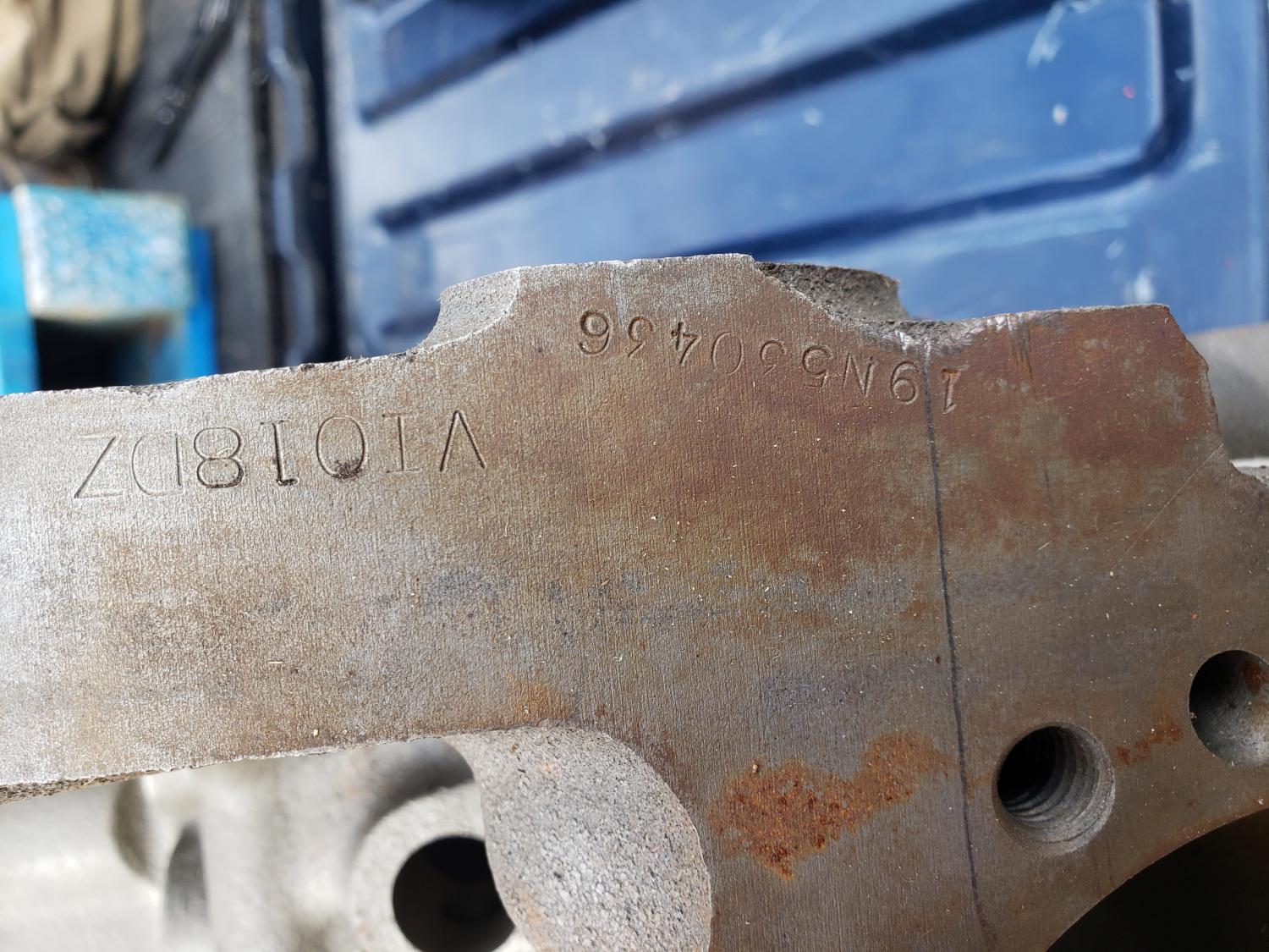

Thanks for all the information folks. I am going to post photos of stamp once the engine lands at my shop. Bare with me old, ugly and slow.

  #30
Old 03-22-2023, 09:16 AM
chris slawski chris slawski is offline
Join Date: Mar 2012
Location: New Jersey
Posts: 398
Thanks: 185
Thanked 115 Times in 64 Posts
Block stamp
