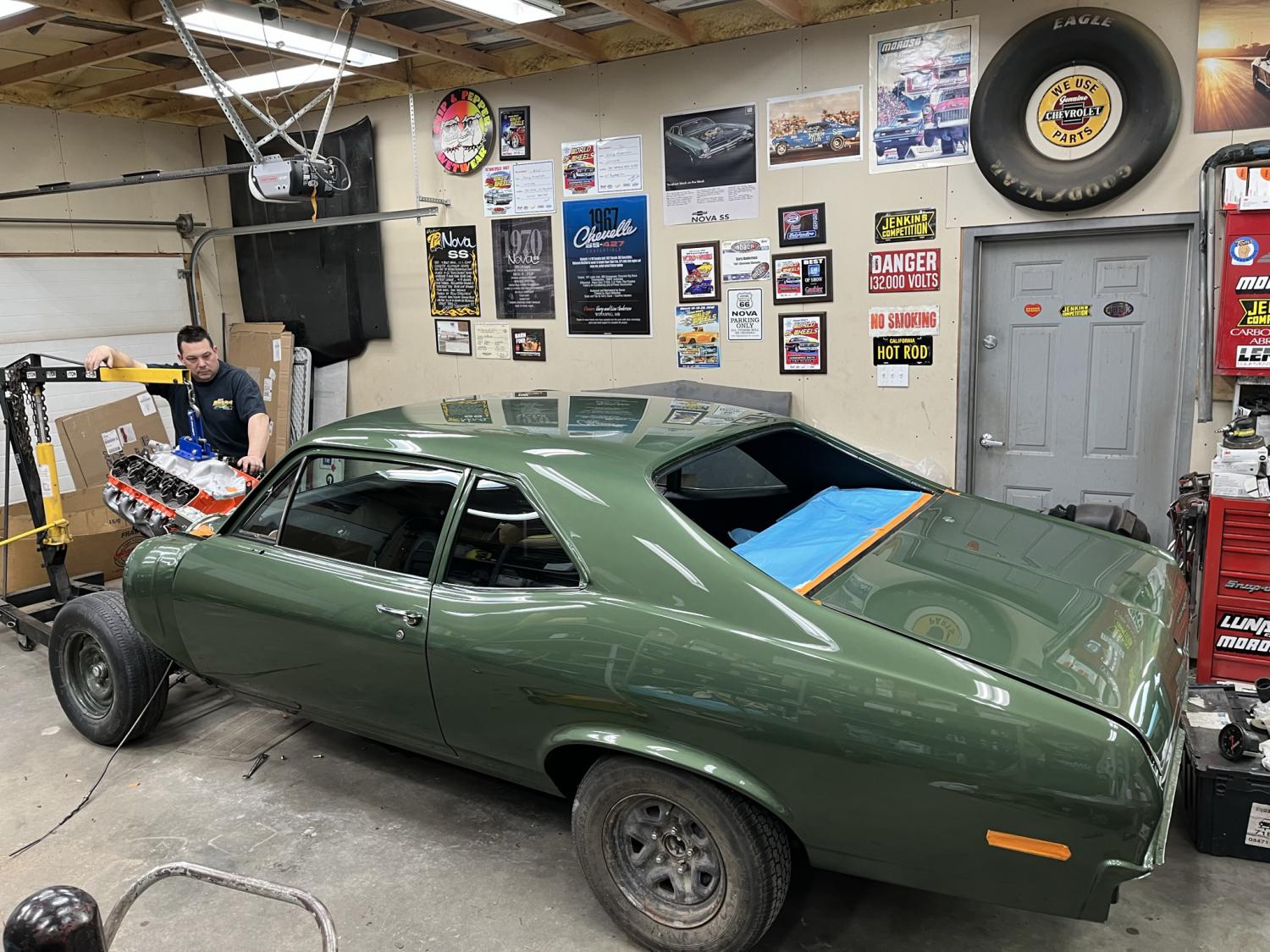

Big D's been a lot a help on the BIG PUSH to finish the car for the March 2023 local World of Wheels show. Here we are putting in the engine, trans.
Note we had also done the windshield.. I had previously picked all the dents, filed, sanded out and polished the reveal moldings. I was still waiting on the back glass... fingers crossed.

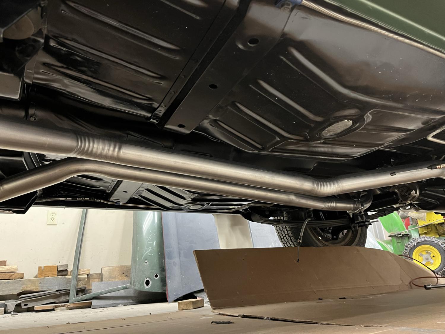

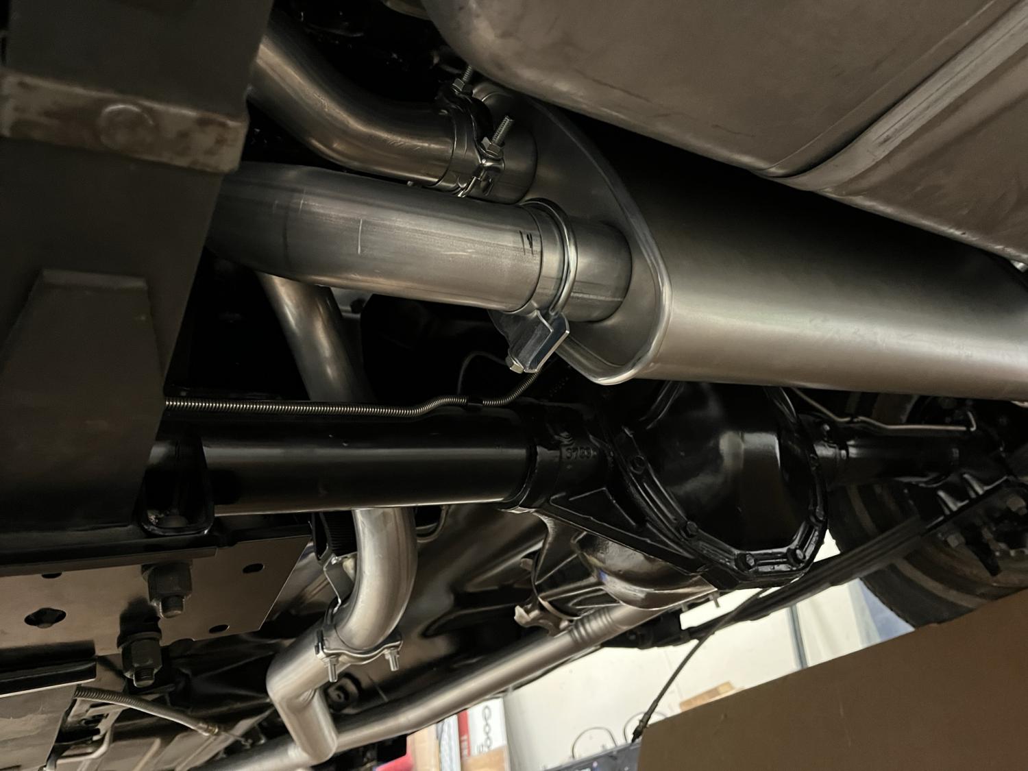

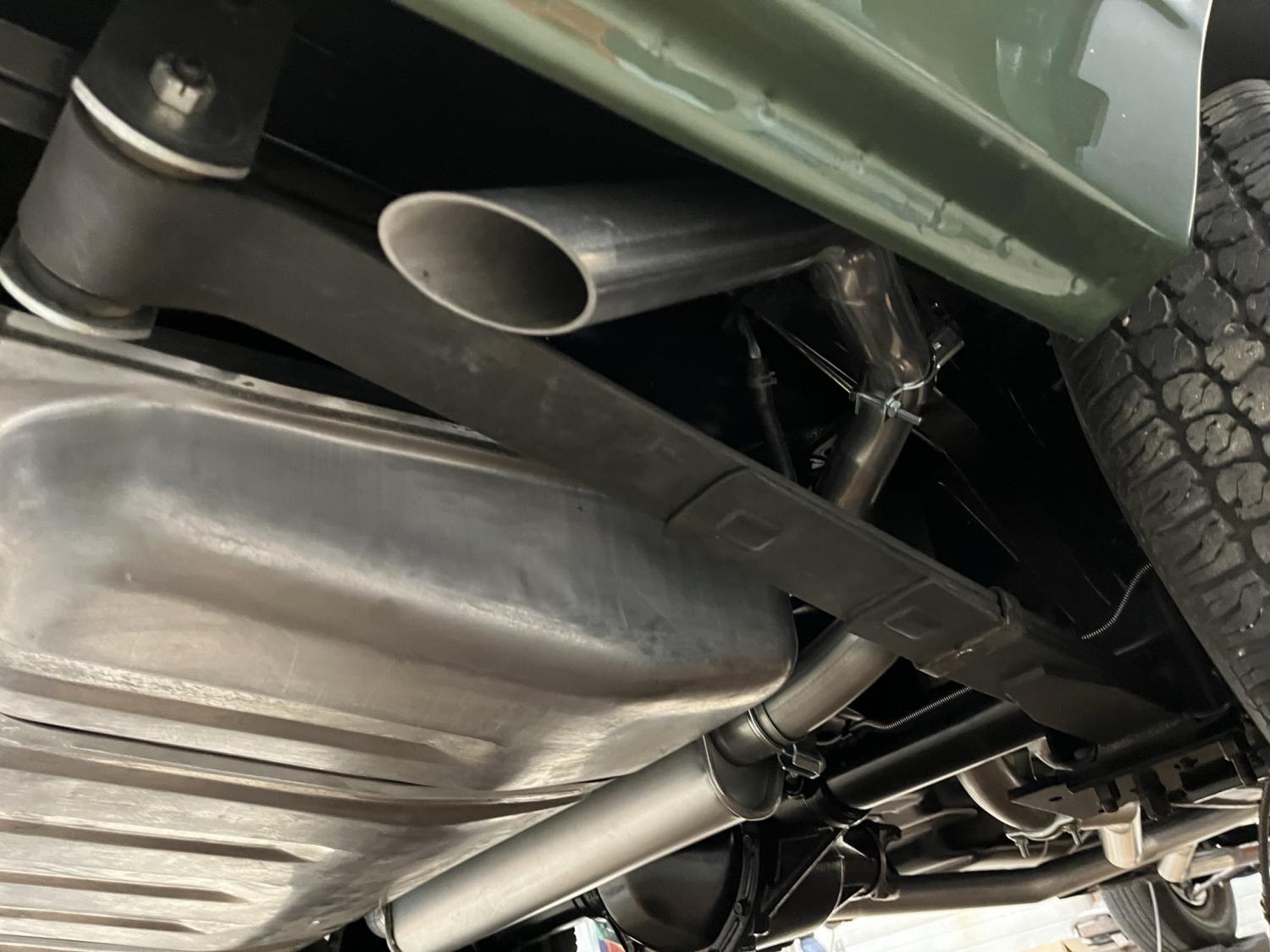

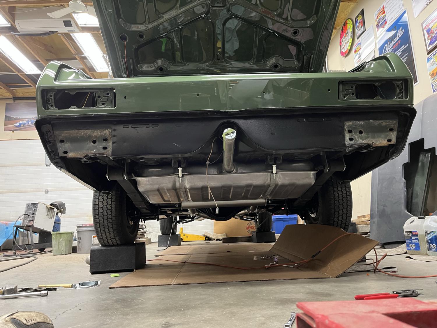

Ooooooooo Gardner Stuff is SOOO NICE!!
I had an NOS heat riser (spot tigged in open position).

Those Gardner Exhaust systems sure do fit nice, don't they. Don't forget to install your inspection cover. Car is looking great, nice job.

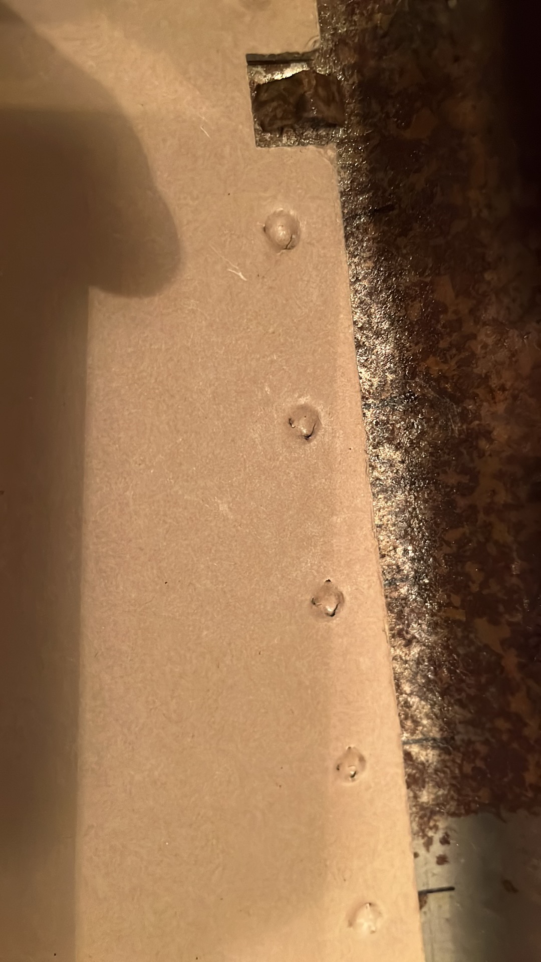

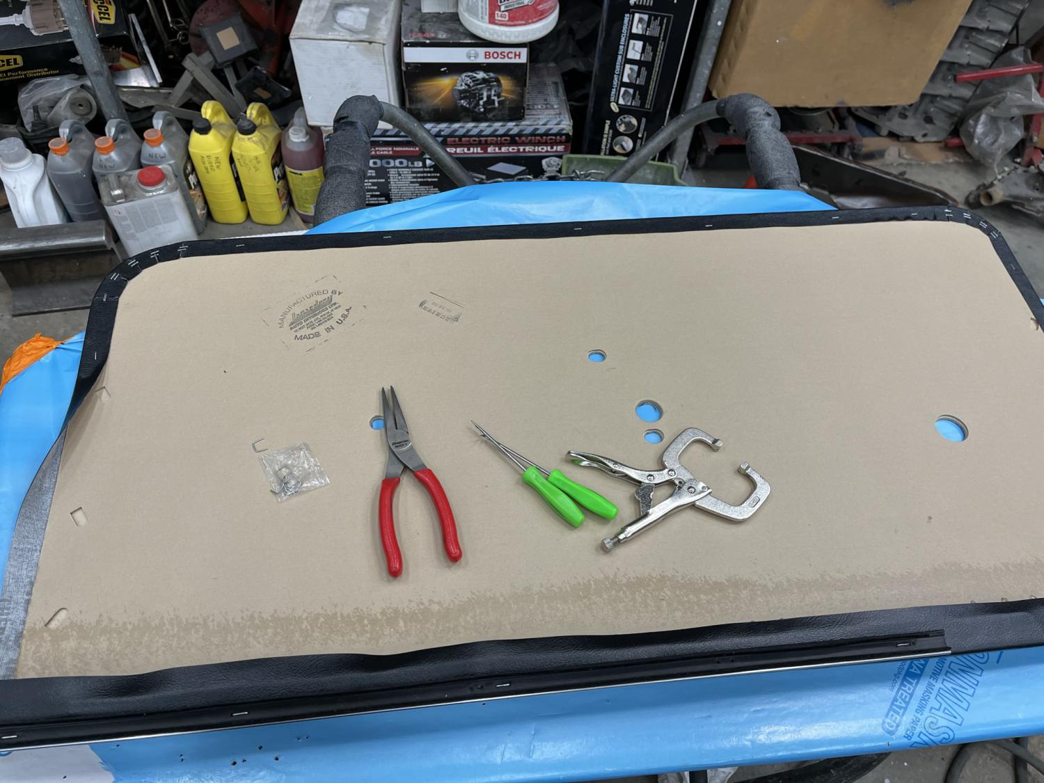

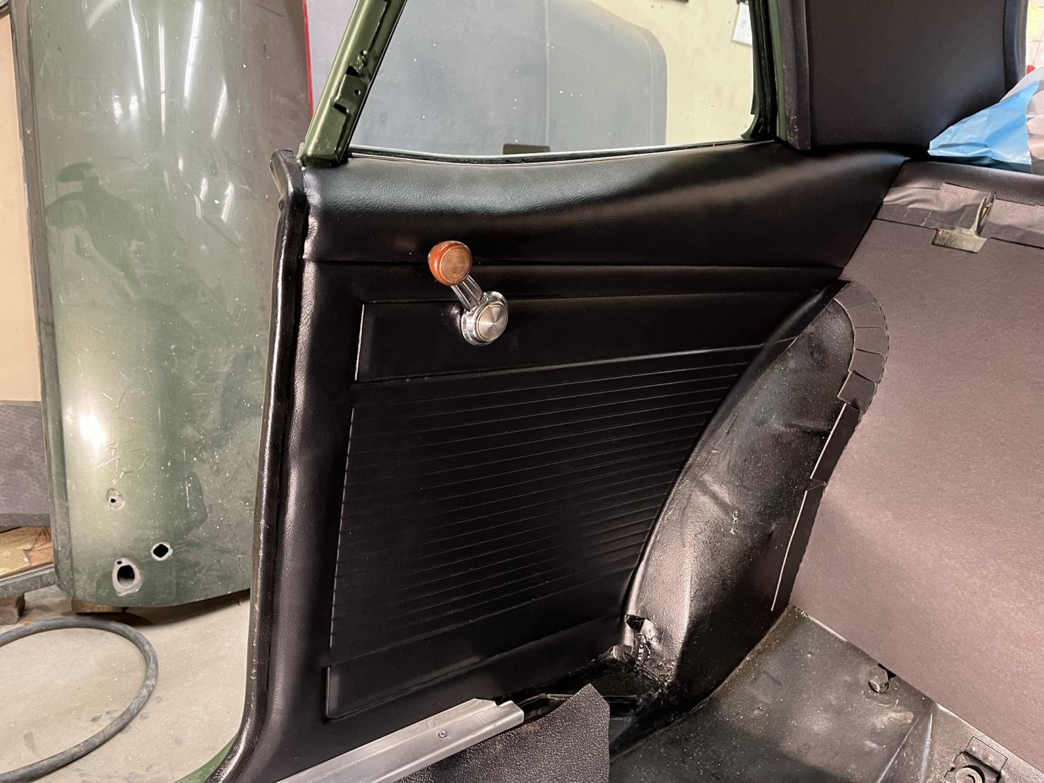

Assembling the door panels.
Stripped off the old steel panel tops. Straightened out all the "teeth" of the panel joiners.
Pre fit the inner window sweeps to ensure the staple holes were all ready to go.
Some spray adhesive and lightly hammered the new panels onto the tops, then peened the claws with a small round headed punch.

Spray adhesive and pull the top vinyl over, then install the sweeps. Staples were painted black after installation.

spray adhesive, trim and wrap remaining edges.

Align and install front panel retaining clips

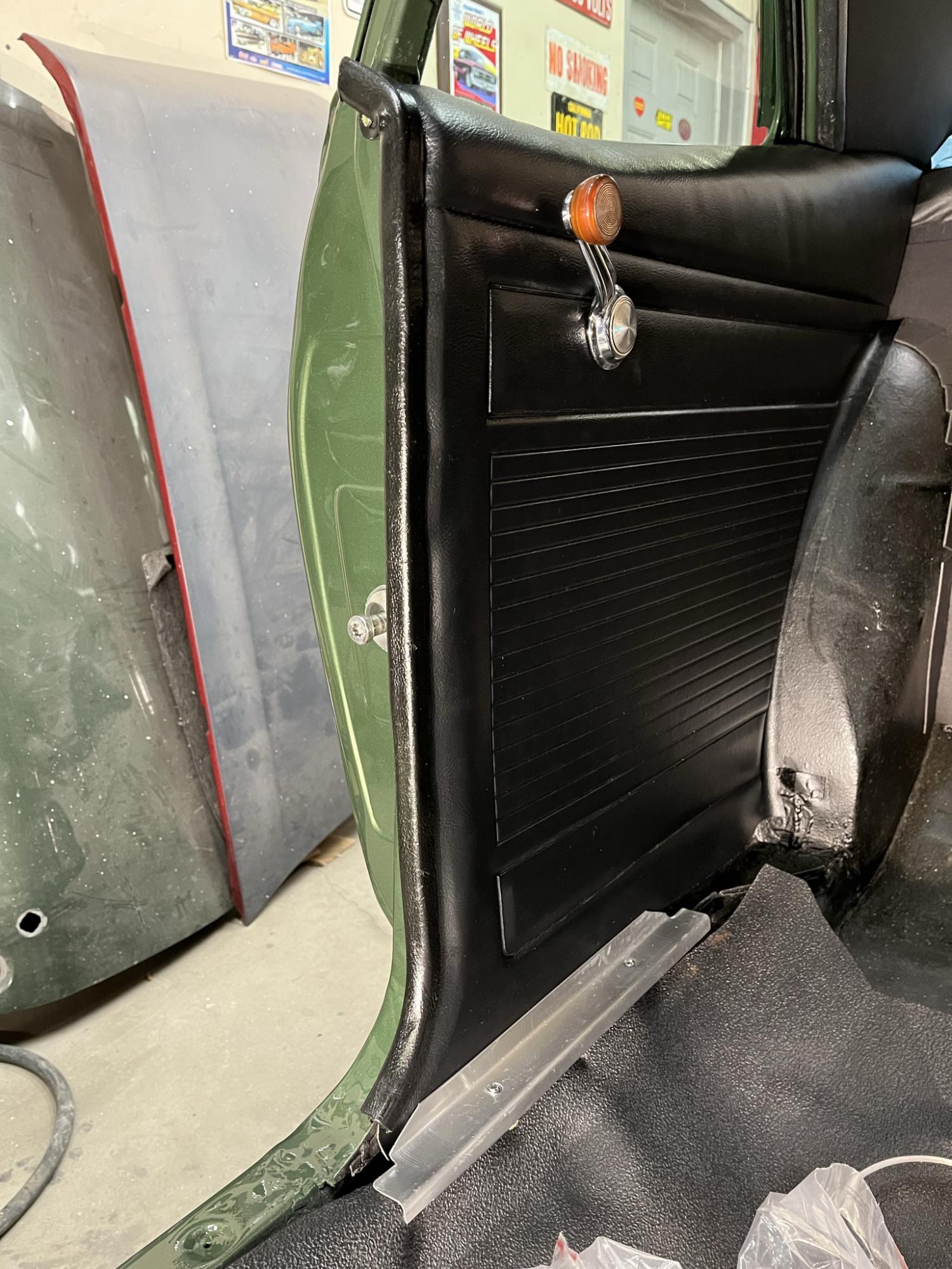

Pic of front door panel installed
